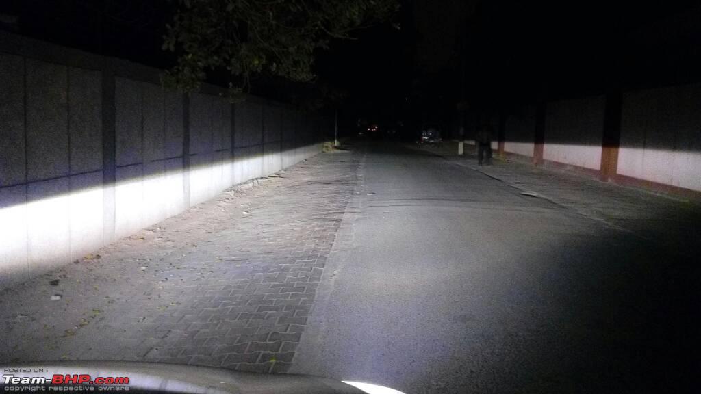

This is the output of my projectors in low beam. Couldn't take a high beam PIC. I always drive on low beam. These are with Chinese HID.

HID will not work without the ballast. hence you will need to change both. If you have got a kit, then the kit would include bulb & ballast.
Yes, HID must have a ballast, but if you have a good one of sufficient wattage then it will not need to be replaced. Remember Hyalutek is as good as any, so it may be Chinese, so what.
