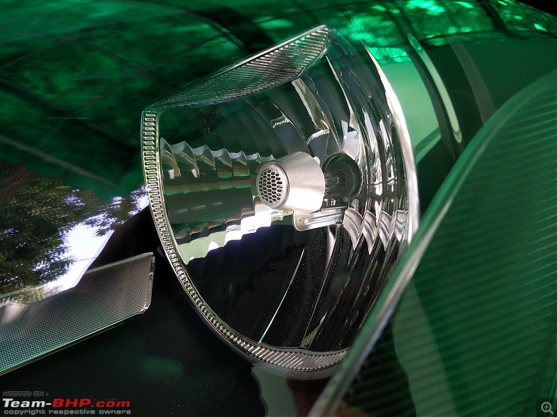

I have a Passat B7 with halogen headlamps. Attaching a pic for reference.
I upgraded the low beam with Morimoto 4300K HID kit and the results are awesome, the cutoff is neat and the illumination is strong. Case in point the halogen bulb also performed beautifully, the illumination was always great. I just wanted the HID look
Anyway, now the high beam bulb looks out of place beacuse its yellow. The highbeam section house a h7 bulb and a w5w parking light bulb.
I want to upgrade this section to match the HID.
I came across two kits Philips Diamond Vision 5000k and Philips Crystal vision 4300K .
What do you suggest is a better bulb. good thing about crystal vision is that they come with free 2 w5w 4300k halogen bulbs to match the color. As they are halogen, they wont throw any errors like T10 leds do.
Also what is the best place ONLINE to buy these. I dont want fakes. Thanks

First - the HID conversion without housing (projector, or HID specific reflector+lens) is illegal - Indian cops don't test meticulously for this so most don't realize it. But if you do get caught and it happens occasionally, so you should know it is illegal.
Steer clear of Diamond Vision and Crystal Vision - they both "look" good, but won't help you "see" better ; and they cause more glare to others. Instead buy either Osram Nightbreakers or Philips Xtreme Vision. Try autotrends.in for Osram. Philips are a little harder to get.

Thanks. I understand HIDs are illegal but not if carefully setup. I have absolutely no glare from the HIDs and the cutoff is very neat.
Infact the low beam kind of falls too short. Is there a way to adjust the beam throw range?

It is a basic rule that HIDs are illegal, when not used in an HID specific projector, or in an HID reflector. You may be right (and a good driver) if your Morimoto kit isn't causing any glares. But I suppose they're still illegal in the eyes of law.
That aside, if you're looking for halogen upgrade for your high beam, try Osram NB+ instead of those 4300k/5000k halogens, as they're simply sold by colour temperate and not actual brightness. The halogens claiming 4300k or above will generally have a tint of blue layer applied over the bulb, which would look cheesy on a premium car like the Passat. You can even consult VW dealerships for the bulb upgrade, though they would suggest higher wattage bulb with ceramic holder and better wiring kit, which would still have the yellow tinge. Nightbreakers have some great reviews and you can try them from an online store, like Amazon.in. Avoid Vicky.in, one known person recieved fake bulbs from the site.
Personally, I would say get some good quality projectors retrofitted for the low beam and shift the Morimoto kit to the high beam. Still illegal (Morimoto part) but won't be causing much problems as you won't use high beam all the time.
About adjusting the throw, Ricci has explained. Didn't you try via the headlamp levelling system?
