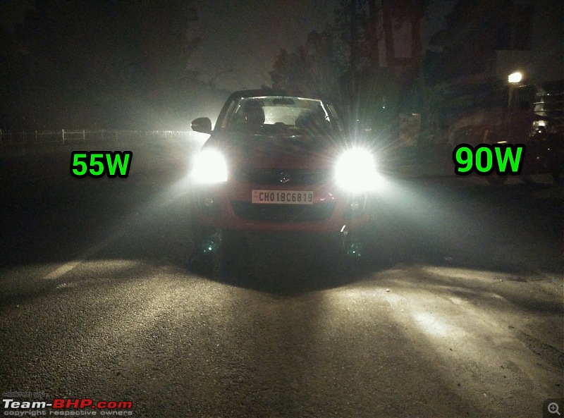

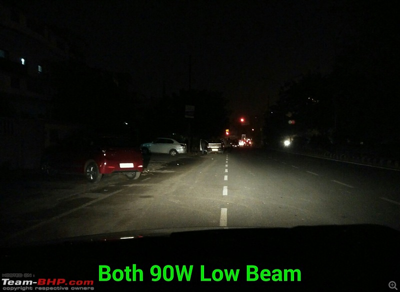

I asked at two shops that stock bulbs like Philips Xtreme Vision Plus, WeatherVision and EssentialVision (the latter two are 100/90W) if my bulbs are genuine and they said they are. Maybe the Rally is no longer being made in Europe. The EssentialVision 100/90W (blue tint glass) was made in Poland as was the Xtreme Vision Plus.
Bought Philips wiring harness for 950 rupees since I couldn't find the Hella made one. Did install myself. Took me 45 minutes mainly because I was looking for the right place to mount the relay and ground connections. I still have to relocate the relay and cable that goes from the relay to the right headlight, the longer one.
As for performance, I didn't really see a dramatic difference. Maybe the bulbs aren't that good or maybe my eyesight isn't that great. Please see the attached pictures. Not much data for comparison there but it might give you an idea. Forget to click picture of the stock bulbs' throw and spread.
Below the air filter box in my engine bay (Diesel), there is a bracket just behind the radiator, I have found that area empty (No pipes or wires running around) and fit for installation of the relay unit.
Unit looks OK after approximately 15000 kms as I was worried that they may conk of due to heat. No change in headlight functioning.
Do look at that place if it is suitable and I have got rid of cable ties. Used bolts to mount the relay unit. Shall send you pictures by weekend as I am not in Hyderabad to gain access.

Thanks Sid, thanks so much for the upgrade. How long have you been using this.
Assume your harness has a ceramic holder. Also are facing any overheating issues or black patches on the headlamp unit.

I did the install on Monday and haven't driven much since then. I actually took advice from Anurag before doing this since he also has a Swift and he had done 12,000 km with this setup without issue. It seems he has done 15,000 km now and still no degradation of the headlights.
Yes, the Philips harness has ceramic holders so it should do fine. I think the Hella product might have better quality. The DIY doesn't take much time if you can identify the places to mount the relay and route the cabling. Quite easy.
