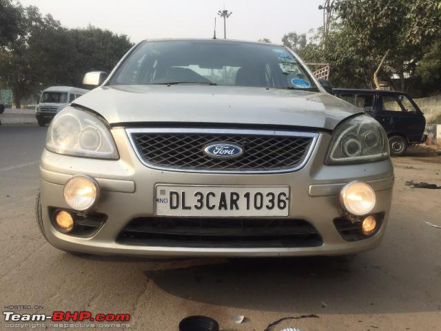

Finally got the aux lamps attached. They're pretty bright and wide for their size. Running 55w h3.
Ps:the bonnet is open.

Default Re: Auto Lighting thread : Post all queries about automobile lighting here
I am looking for a setup like this too.
1. Where did you get the installation done from?
2. Do these shake while driving?
3. I don't have projectors in my car, just want something that lights up the road properly and I am able to see further away (without blinding oncoming vehicles). My low beams disappoint wrt to the distance and brightness.
4. Price of the lamps and the installation cost.
Thanks!
Thanks!
Got it done from my fng. The attachment is done on solid 5 mm bits of steel welded to the frame and out from the fog lamp gaps,so no bumper holes.
The projectors are useless. Stick to stock. Get higher wattage bulbs.
The lamps are 600 bucks , the installation is 400 all inclusive.
And about vibrations, I don't know yet. Will tell you after a drive tomorrow.
