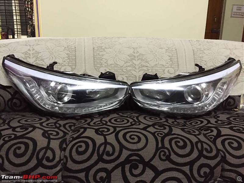

Hi guys,
A query.
My friend got me the OEM Fluidic Verna projector headlights from Seoul. It is the original headlights procured from Hyundai Mobis.
Auto Lighting thread : Post all queries about automobile lighting here-imageuploadedbyteambhp1452486692.702518.jpg

The OEM projector lights
Now the problem is when I try to fit it to my existing car which comes with the halogen headlamps (non projector type).

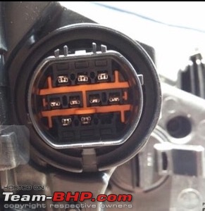

My car has a 8-pin (female) pig tail headlight harness.
Auto Lighting thread : Post all queries about automobile lighting here-imageuploadedbyteambhp1452486774.175534.jpg
The projector headlights come with a 10-pin (male) pin out.

Originally Posted by drhoneycake View Post
Hyundai authorised service centre is not ready to splice wires.
One suggestion: if you must splice, then splice it on the head-lamp side.
1. Get a couple of faulty /damaged headlamps from the body shop.
2. Get the connector from these (to match the supply side connector) (the round-ish type that is in your car).
3. Splice the wires on the new lamps to use the connectors that you have got from above steps.
Hi guys,
A query.
I also have a wiring diagram which tells me how to wire the whole thing up. The problem is I don't know jack about wiring/electricals. Hyundai authorised service centre is not ready to splice wires.
The wiring diagram
The wiring as supplied in the packaging
Can anybody help me set it up???
One issue, I am not sure whether you will run into problem with the RHD / LHD issue. Dipping in the wrong direction.
Yes sir, I was aware of that. It's a RHD headlight assembly sir. Don't want to be annoying people on the road with the wrong beam pattern.
Wanted to upgrade to HID's and didn't want to do it without projectors. Don't want to blind people. (I have been blinded enough in the city and on the highways). Hence this project.
