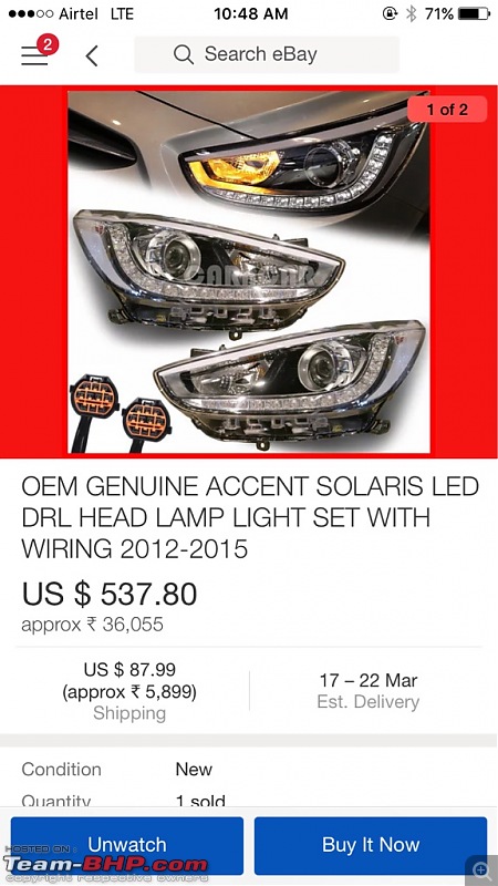

Contacted Hyundai Mobis and checked 99rpm for the OEM projector headlights and got a shock of my life. A single projector headlight assembly costs a whopping ₹45,000/- without the mounts, bolts etc. So that option was ruled out. There was no way I was gonna spend ₹1 lac on a pair of headlight assembly.
Auto Lighting thread : Post all queries about automobile lighting here-imageuploadedbyteambhp1457759830.206807.jpg
Began searching for cheaper options on hyundaiforums.com and came across an eBay seller selling a brand new piece (a pair) for just ₹35,000 + ₹6000 for shipping. As luck would have it, I was to goto a conference in Seoul, Korea. After finishing my work and going around town, I happened to meet this eBay seller in person check out the headlamps and placed an order.
Auto Lighting thread : Post all queries about automobile lighting here-imageuploadedbyteambhp1457760077.842016.jpg

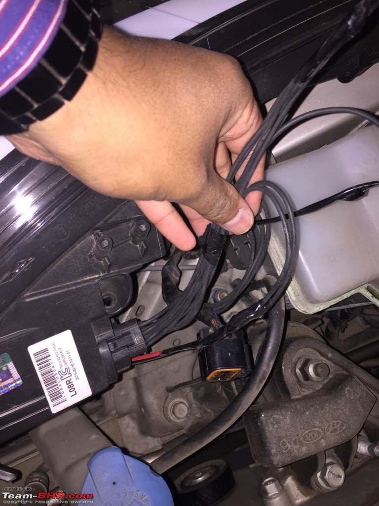

Absolutely brilliant packaging. Product was as described. Came with the additional wiring and a wiring diagram.

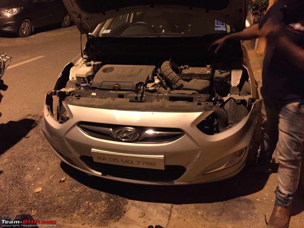

So the first thing I did was take it to Hyundai who said they couldn't do it because they had to splice the original headlight harness and that would be against company policy.
Next asked my query on this very same thread and came in contact with SunnyBoi. Believe me when I say this. This man is a legend, got the whole thing setup beautifully. He has every possible thing you'd need to modify your car in any way whatsoever. Very skilled and absolutely neat work. Got the DRL's wired to the ignition and the rest of the setup as mentioned in the wiring diagram.
Auto Lighting thread : Post all queries about automobile lighting here-imageuploadedbyteambhp1457760994.323476.jpg
Auto Lighting thread : Post all queries about automobile lighting here-imageuploadedbyteambhp1457761019.736014.jpg
Auto Lighting thread : Post all queries about automobile lighting here-imageuploadedbyteambhp1457761070.210768.jpg
Auto Lighting thread : Post all queries about automobile lighting here-imageuploadedbyteambhp1457761099.444424.jpg
Auto Lighting thread : Post all queries about automobile lighting here-imageuploadedbyteambhp1457761127.006854.jpg
Sunnyboi working his magic

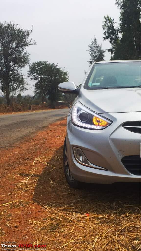

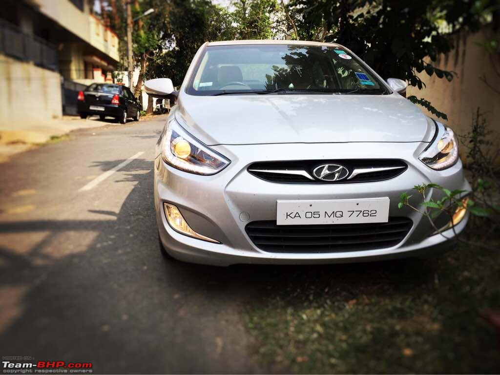

Now, coming to the headlight performance, in one word - Brilliant. Complete upgrade. The low beam throw is marvellous and in most cases sufficient for night drive. I now use the high beam only for flashing for overtakes. In city only the low beam is adequate, I don't even use the fogs now.
I'm extremely happy with this new setup, the headlight performance has improved tremendously and it gives the car a mean and upmarket look. Aesthetically beautiful and functionally brilliant.
Auto Lighting thread : Post all queries about automobile lighting here-imageuploadedbyteambhp1457760935.728195.jpg
Auto Lighting thread : Post all queries about automobile lighting here-imageuploadedbyteambhp1457760891.470788.jpg
Auto Lighting thread : Post all queries about automobile lighting here-imageuploadedbyteambhp1457760850.706581.jpg
What's next - 55w HID's.
Bottom line:- If anyone is contemplating a light upgrade, projectors is the way to go. I'm sure you would not regret and please donot plonk in HID's unless you have projectors. There are enough morons who are blinding people on the road.
