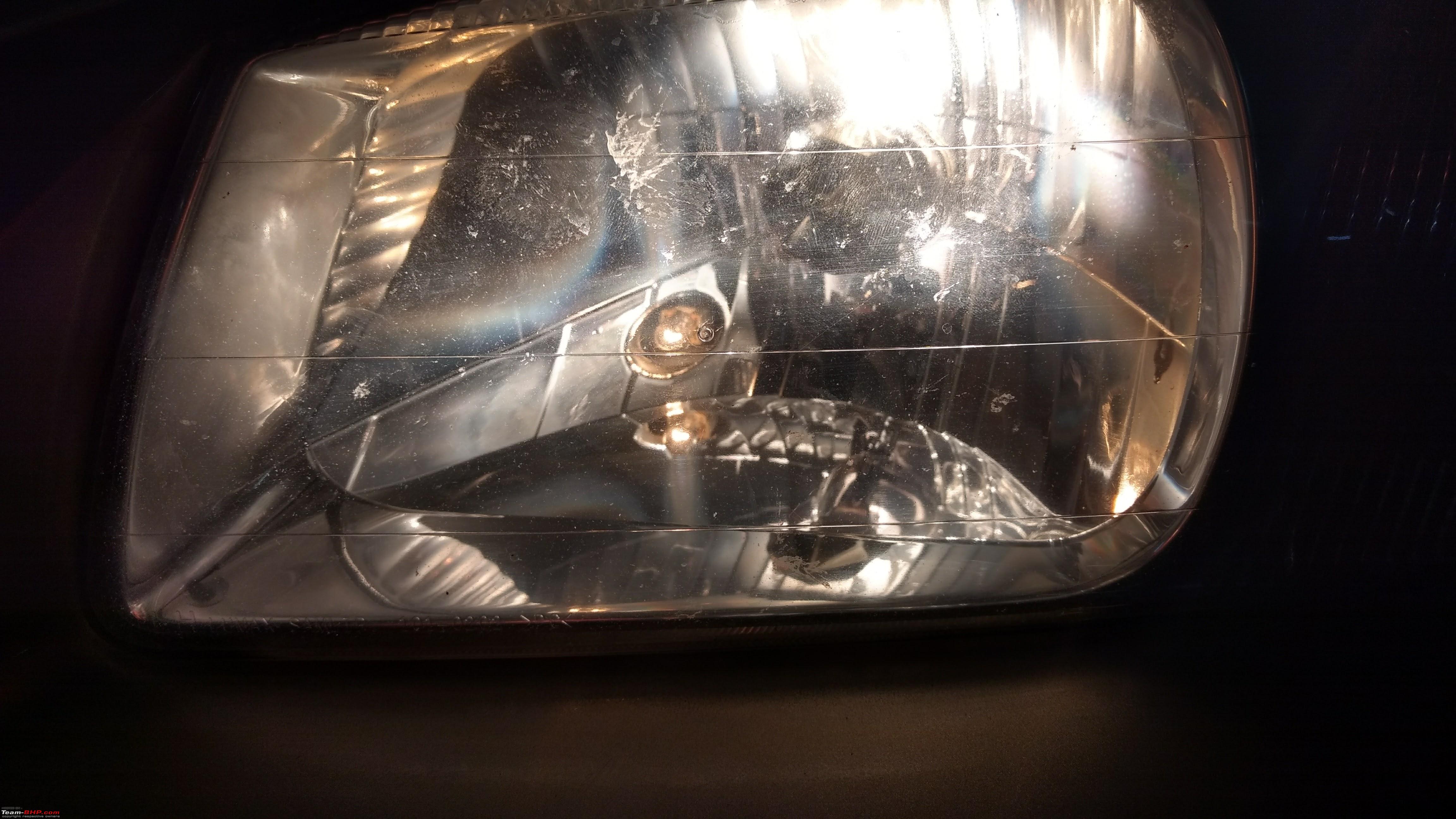

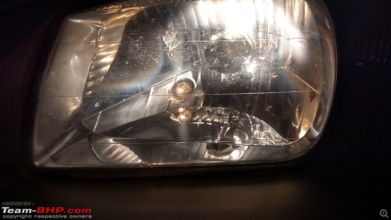

Also, while he was changing the bulbs, I noticed something disturbing -
Auto Lighting thread : Post all queries about automobile lighting here-img_20170520_175210737_hdr.jpg
Notice the black area on the left? Looks like the reflector is burnt or something. The only question is how? I've been using 60/55 bulbs till now.
Auto Lighting thread : Post all queries about automobile lighting here-img_20170520_175205810_hdr.jpg
Some more weird marks on the reflector.
Any idea guys?

Originally Posted by nerd1200 View Post
I however also wanted to consider 130/100s. What are the cons of using this over 100/90s in a stock setup?
130/100 is actually an extreme option.
The light output is a bit more better than 100/90, but the heat produced is far more serious than what we expect.
It is strictly meant for use in older type headlight units with metallic/ceramic reflectors & real glass outer-covering.
Do not use it with the modern type headlights with clear-lens plastic glass and plastic reflectors, because in most cases it will cause gradual fading of the plastic glass and reflectors.
In some cases, it may even melt the reflectors depending upon the shape of the reflector.
Current drawn by 130W bulb is also higher, and it puts a heavy load on the battery and alternator.
So don't take risk if you have a clear glass healight with plastic outer-glass and reflectors.
I have used Philips Rally 100/90 H4 bulbs for several years in different cars that I owned, and I have found it to be very effective than most other options.
100/90 is more than enough for any person with normal vision.
In my opinion, if 100/90 is also not adequate for someone, he/she shouldn't be doing night driving at all.
The disturbance and the blinding effect that you create to others with a 130W high beam is far more in magnitude than the illumination improvement that you are creating for yourself.
