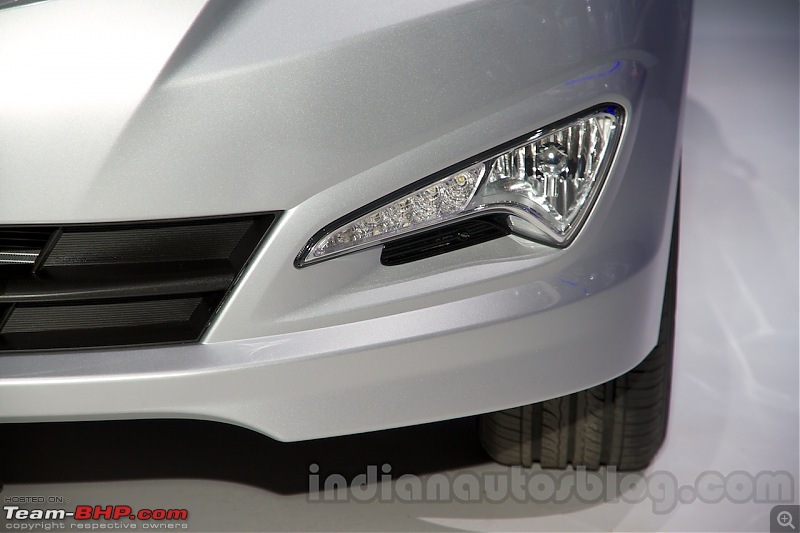

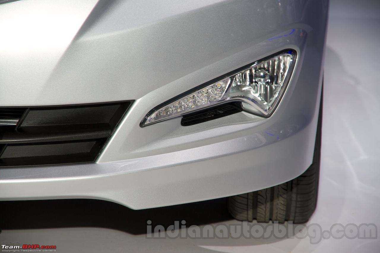

Originally Posted by PearlJam View Post
Thanks for all your inputs!
Just to clarify, I already have the OEM projectors in my Verna 4S. They work pretty well, but it lacks LED DRLs. I have three main requirements, in order of priority:
  1. No wire cutting for the sake of warranty
  2. Add LED DRLs that doesn't stick out like a sore thumb. Some people put an extra LED strip, which I do not want.
  3. Increase brightness of the OEM projectors. Though they are OK, a little more brightness would do no harm!
The pre-facelift Verna used to have an option for OEM projectors that came along with LED DRLs. But the issues with them are (a) Way too expensive, more than a lakh for a set (b) Doesn't look that great anyway for that price (c) Brightness of LED DRLs is low (I've seen on a couple on the road), and brightness of projectors is same as what I already have.
Upgrading the Halogens to 100w may not be worth it, mainly due to the extra heat and other relay/changes anyway. I may as well move to HIDs in that case.
If I want to only meet my requirement (1) above, then there is also an option of buying the foglamp that has DRLs in it - They involve just a straight replacement of the OEM fog lamps:
But again, these are relatively cheap chinese replacements from aliexpress, and I'm not sure of the brightness of the DRLs, as well as reliability.
Thoughts?
These are what OEM DRLs on Accent Solaris(Russian version) look like.
Auto Lighting thread : Post all queries about automobile lighting here-hyundaisolarisfacelift2014moscowliveleddrl.jpg
Auto Lighting thread : Post all queries about automobile lighting here-hyundaisolarisfacelift2014moscowliveleddrl1.jpg
Auto Lighting thread : Post all queries about automobile lighting here-hyundaisolarisfacelift2014moscowliveleddrl2.jpg
I tried looking for them but, they prove extremely hard to find.
These ones look way better in my opinion.
Also, the pre-facelift verna had LED 'parking lights' and they were never meant to be used as DRLs, just like what you see in present gen Creta.
