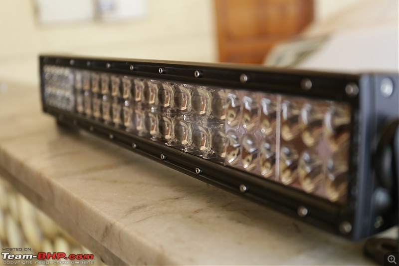

Rigid is very good but there are other choices in the high priced LED light market and one such company is Baja Designs they make some excellent lights and I am going to put a set of their pods on the vehicle. Rigid let me see if i can mount it lower if it stays with me. Problem with the Rigid i have is it puts too much light down the road, which means i should be super careful when i use it. The pics doesn't do justice at all.
Rigid E2 Combo
Auto Lighting thread : Post all queries about automobile lighting here-img_0378.jpg
Multiple projector like lenses for throwing light down the road. Looks like spider eyes!
Auto Lighting thread : Post all queries about automobile lighting here-img_0377.jpg
Specter optics which provides the driving beam
Auto Lighting thread : Post all queries about automobile lighting here-img_0373.jpg
Special unique key light locks.
Auto Lighting thread : Post all queries about automobile lighting here-img_0375.jpg
The nut has a code laser etched on it's other side which is needed to get a spare key made.
