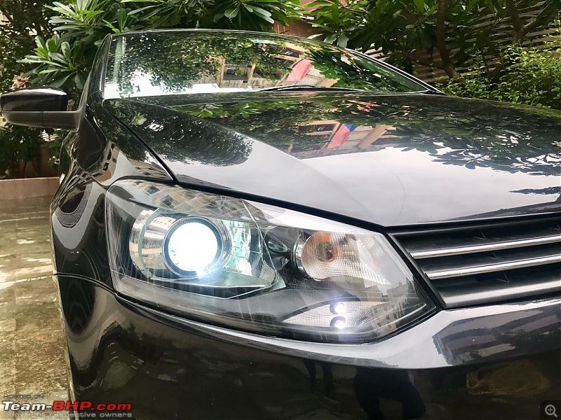

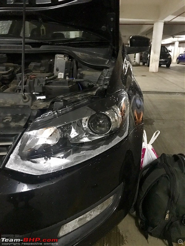

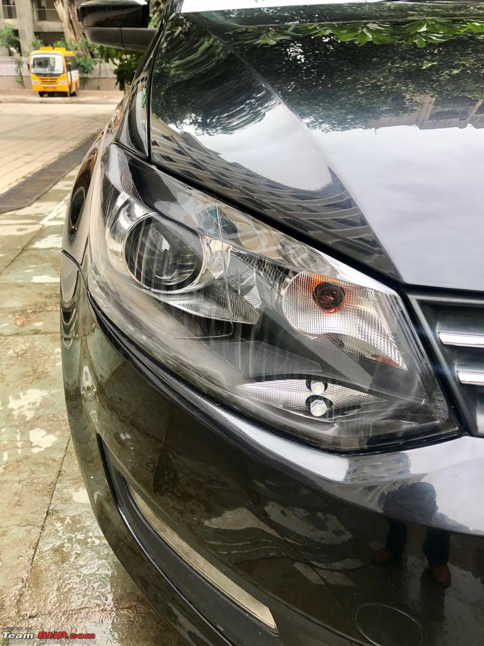

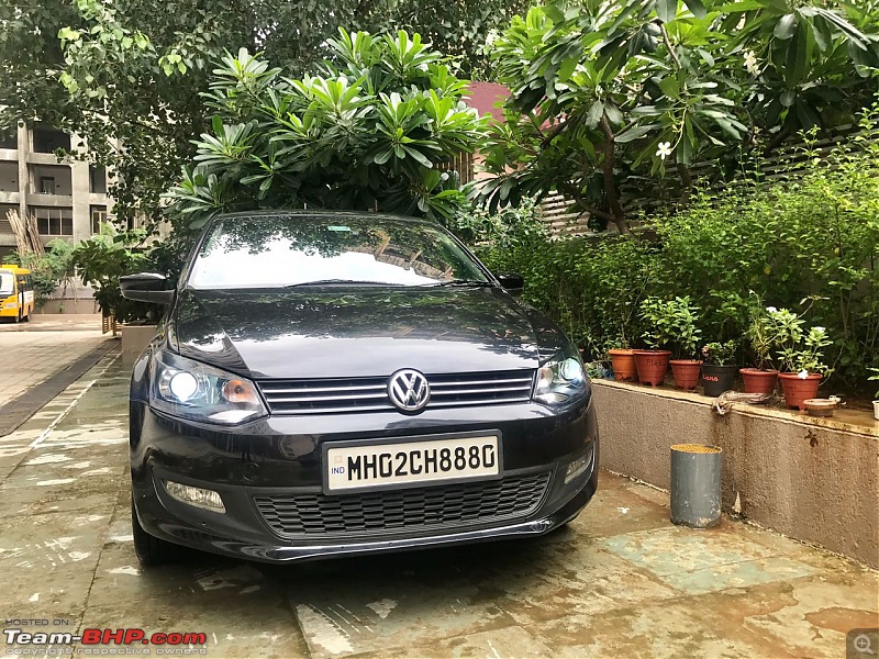

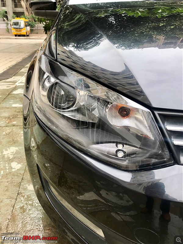

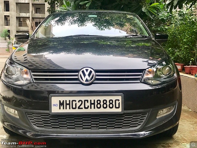

Retrofit Projector Setup in 2011 VW Polo 1.6
So after a lot of deliberation, I finally took the plunge and upgraded my H4 halogen headlight setup to a H1 bi-xenon projector setup.
The work was done by Xenon Planet and we used their XP Mini Super V3 Projectors.
I am pretty happy with the over all work and the entire set up looks absolutely stock. The only problem I currently face is fogging in the headlight which I assume will clear off in due course of time. Here are some pics -

Sorry to be a party pooper, the alignment is OFF.
Fogging is due to moisture inside. Did you pressure wash the car within 2-3 days of the install or left it standing in the rain? If not, the resealing is not done properly.

Alignment is not OFF, the 1st picture of the light throw says it is nearly perfect. If you are referring to the 2nd picture it is the high beam of the Bi-xenon.
RHS one is.
Auto Lighting thread : Post all queries about automobile lighting here-headlight-low-beam-cut-off.jpg
