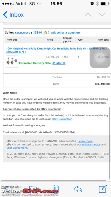

Default
Originally Posted by Akib Khan View Post
Printh i guess you got a bit confused. The bulb comes as 130/100 W. Kindly check the source from where you bought it.
I am pretty sure of the wattage rating guys. Actually,the 130/90 W rating is not specific for India. I saw the bulb on Amazon USA site and booked it in EBay India.
Attaching a screenshot from my mailbox for reference :
The make is Hella and model is Rally. The Philips counterpart in Indian sites had only 130/100 W setup and not 90 W for low beam.
