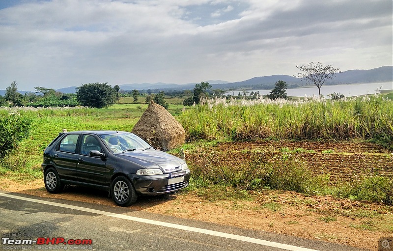

Default Re: Auto Lighting thread : Post all queries about automobile lighting here
Originally Posted by TorqueyTechie View Post
3. Would going for HID's is right or should I go with LED's?
Something for you to ponder
Auto Lighting thread : Post all queries about automobile lighting here-img_20151205_1504172001-copy.jpg
A video made when testing /aiming the light.

Thanks sunnyboi. Did you get this done because of difficulty in setting up HID's? How much did this setup cost you? I would keep this as my last option if I am unable to replace the OEM lights.

Could you share the details of the light bar, like wattage, size and landed cost?

I have 4 projectors with me to try a quad projector setup. SOmewhere down the line I lost interest and bought the Lightbar instead.
Its a 210W 20inch lightbar. Cost me 120$ from aliexpress and it has Osram LEDs.
Do you have a link to the item or the seller? How is this seller? Am interested in smaller light bars/pods.
