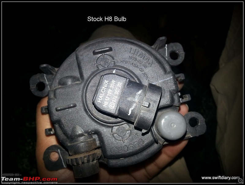

Upgrading from H8 35W to H11 55W fog lamp bulbs - Swift
H11 and H8 bulbs are physically very identical to each other in filament placement and size, but the former is brighter 55W and used as headlamp bulbs in some cars and the latter is 35W used mainly as fog lamp bulbs. Although the bulbs are very similar the H11 bulbs do not go into holder designed for H8 bulbs because the center locating tab of the H11 is wider by a few millimeters compared to the H8's. But its very easy to modify the Swift's fog lamp bulb holder to take the brighter H11 bulb. It takes less than 10 minutes to do each lamp with care.
H8 and H11 bulbs - Halonix H8 and Philips H11
Auto Lighting thread : Post all queries about automobile lighting here-20140402_195908.jpg
H8 bulb in holder
Auto Lighting thread : Post all queries about automobile lighting here-20140402_195253.jpg
Auto Lighting thread : Post all queries about automobile lighting here-20140402_195302.jpg
H11 bulb wouldn't fit in holder
Auto Lighting thread : Post all queries about automobile lighting here-20140402_195401.jpg
Auto Lighting thread : Post all queries about automobile lighting here-20140402_195356.jpg
Where to cut
Auto Lighting thread : Post all queries about automobile lighting here-20140402_195324.jpg
Auto Lighting thread : Post all queries about automobile lighting here-20140402_195746.jpg
There is an improvement in lighting compared to the stock H8 bulbs, with H8 I coudn't notice if the lamps were on or not, it was weak and didn't put out any useful illumination. Now with H11 bulbs the lamps do make their presence known and illuminates to the sides and to the front a bit better. If even more lighting is required higher output variants like Osram Night breaker Plus and Philips Xtreme Vision are available in H11. With H8 there are no high output choices except to go HID and i don't want HID.

Re: Upgrading from H8 35W to H11 55W fog lamp bulbs - Swift
I had also planned a similar mod for the fog lights on my Swift but dropped the idea after the right bulb had to be replaced 2 times in under 3 months! I wonder what could be wrong. MASS says the fog lamp switch was always left on and so the bulb fused.
Pardon the question,but will this extra 20w load on the system cause any reliability issues ?
Surprising but I feel it could be an issue if used always in the nights. Why don't you check the fog lamp wiring.
I don't remember how many times I would have used my cars fog lamps. I don't find any sense in using it in Hyderabad weather where 'Fog' is hardly seen.
If it's the additional load, then it's not the bulb but the fuse that has to blow up first. I would suspect the holder. Take a closer look when they open it up next time.
The so-called fog lamps in Suzuki cars are there only for cosmetic reasons. They are just a pair of powerful park lights, with their short throw and 35W bulbs. I have HIDs in them, so the foreground is good.
I haven't yet installed the H11 55w bulbs. Its the H8 35w 'Halonix' bulb which has failed twice in less than 3 months. MASS says it could be because I leave the fog light button on at all times.
shashank.nk is offline
In my case it is the fog lights and some brand called 'Halonix' which I believe is what MASS uses. The new one installed is also Halonix only. If it fails in anything under than a year,i'll be pretty upset.
The stock bulbs last! But there is some issue in your setup - may be wiring or the holder (as Silversteed mentioned). Get these doubts cleared then I don't think they'll fail.
I haven't yet installed the H11 55w bulbs. Its the H8 35w 'Halonix' bulb. MASS says it could be because I leave the fog light button on at all times.
35W for a fog lamp?! I was thinking so long that it to be 55W H8 (Just checked my owners manual)
Why don't you try Philips or Osram in the stock fog lamp rating to see of they fail or no (I know it is not economical but a try can be given).
So if a switch is ON always how will current pass and fuse the bulb when the main headlamp switch is not activated?! What is the fuse box doing then?
Philips or Osram will be tried but I somehow feel this is a issue with wiring or may be holder as silversteed mentioned.
According to them,leaving the fog light switch 'on' at all times may cause the bulb to blow out,something about excess current causing it when both parking lights and fog lights are turned on at once. It should be parking light first and later the foglights,not both at once. I'm not convinced with this though.
This is like them saying, leaving the engine ON always will seize the engine!
So they are telling the order of usage? Parking lamps -> head lamps -> fog lamps?
I have one doubt: The next time your in the car, at idle with instrumentation console lit up (only parking lamps switched ON will do), switch ON the fog lamps, what is the drop in RPM and how much time does the RPM take to stabilize back?
Halonix is a good brand. Your LHS bulb is still fine, so there're no quality issues with the bulb. Please get your wiring checked, including the battery terminals. Spikes can be caused by loose connections at the terminals and the holder.
Leaving the fog-lamp switch on is not a problem, because I used to do the same until I installed HIDs 3 months ago.
Excess current flows when there's a spike in voltage in that line. The sequence you're asked to follow is probably another load of bull like the "Oxygen-free copper" for powering amplifiers. The additional 6 Amps of current needed to turn on the park lights together won't increase the load on the engine so much to show up as a drop in RPM on the tacho. You may need an OBD scanner to see that.
