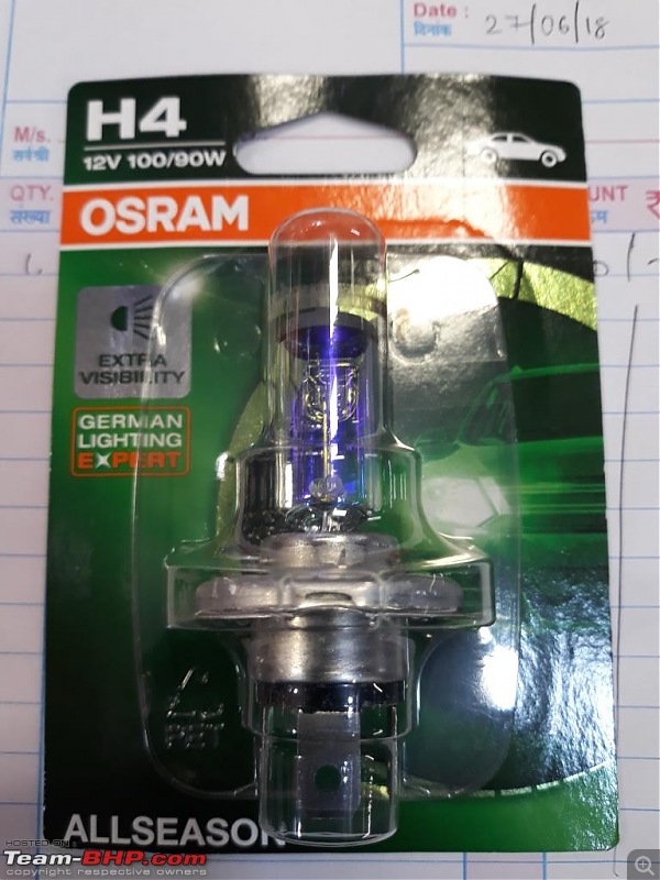

Hi Guys,
As the monsoon has started, I was looking for some brighter lights for my Nano XT in Bombay which is presently fitted with Philips Extreme Vision 55/60W.
My local accessory shop is offering me these OSRAM All Weather bulbs at Rs. 370.00 each. Yellowish light. Made in Germany and with a lifetime warranty!! However, the wattage is 90/100W and he is insisting that there is NO NEED for a relay. He has original Philips relays but questions the need for all the extra wiring. I am a bit doubtful about not fitting a relay for 90/100W bulbs.
Has anyone fitted these bulbs and if so, would appreciate some feedback.
1. Did you fit a relay?
2. Effectiveness of these bulbs.
3. Cost per bulb.
Thanks & Regards,
SS
Suzuki san, the lifetime of the bulbs is not even the lifetime of the car ! And pls get the relay if it is 90/100. Also ceramic holders if you can.
condor is online now   (1) Thanks

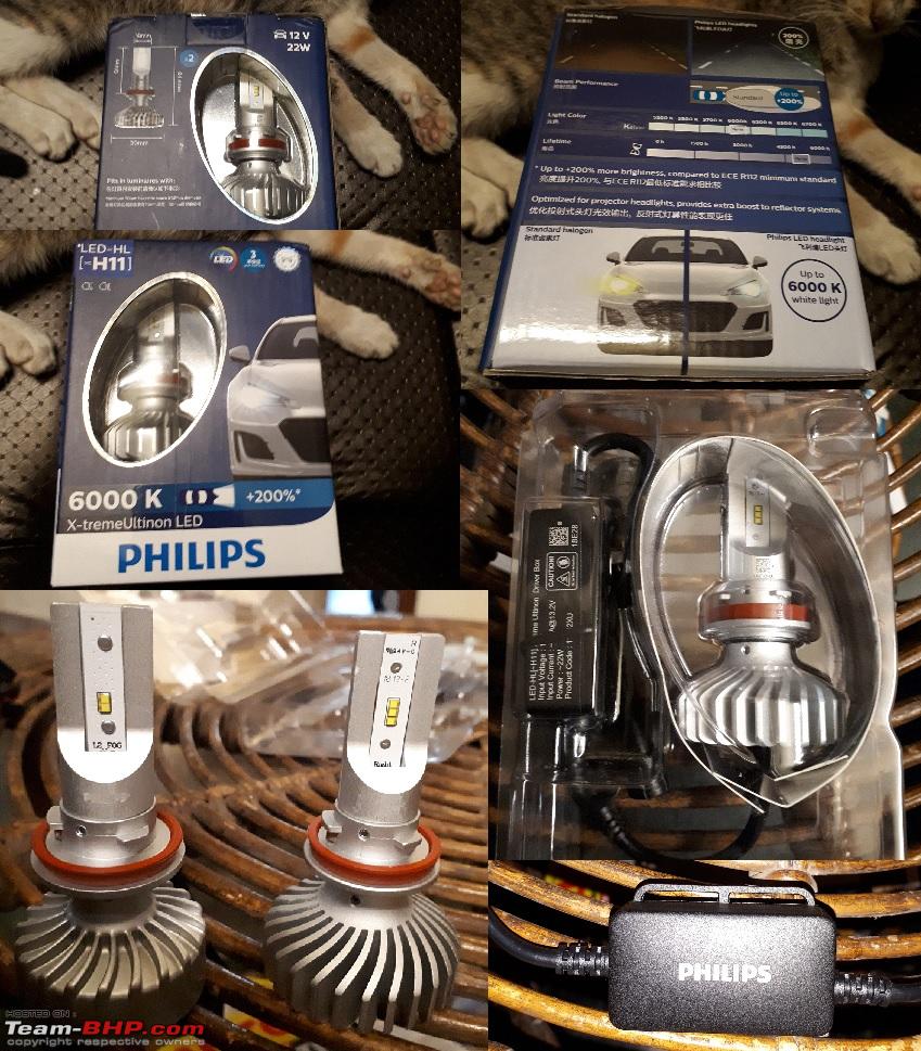

Philips H11 LED 22W Headlight
Proper LED headlamp bulbs are already available in the market and some are really good. Most are made by chinese manufacturers which sell them under various names and some of them are top quality stuff. Main thing that matters in these LED replacement bulbs are the positioning of diodes which should match the filament position of the halogen it is replacing. Many manufacturers and sellers claim theirs work the best but when Philips came out with one of these replacements it was a no brainer to get one of these going by past experience with their H11 LED Fog (in fogs and headlight low beams of Crysta). Also I wanted to stay with Philips/Osram since all LEDs on my car are now either one of these two brands.
These are not sold in India as on date. I wonder why they don't sell it across all markets like they do with the H11 fogs, H4 and H7 headlights. Anyway these are genuine and the scratch code authenticated it. This is from their Xtreme Ultinon series.
Initial impressions are good, they shine brighter and the beam is stronger compared to the H11 fogs i had installed in low beams of my Crysta with good results. Philips rate these bulbs at a conservative 1350lumens. I read somewhere that Philips lumens rating for LED bulbs are measured at max operating temperature. The cooling is passive with a heatsink.
The bulb is designed to be used in both projector and reflector headlights and is adjustable.
I will post a video later. Leaving this collage here for now. The H11LED fog and H11LED Headlight bulbs are at the bottom of the collage. One on the left is H11Fog (11W) and it does not have a separate driver and the driver is in its base. H11 headlight (22W) has a proper heatsink and a separate driver which is inside a sturdy black aluminium box.
Auto Lighting thread : Post all queries about automobile lighting here-h11collage.jpg
Sankar is offline   (4) Thanks
