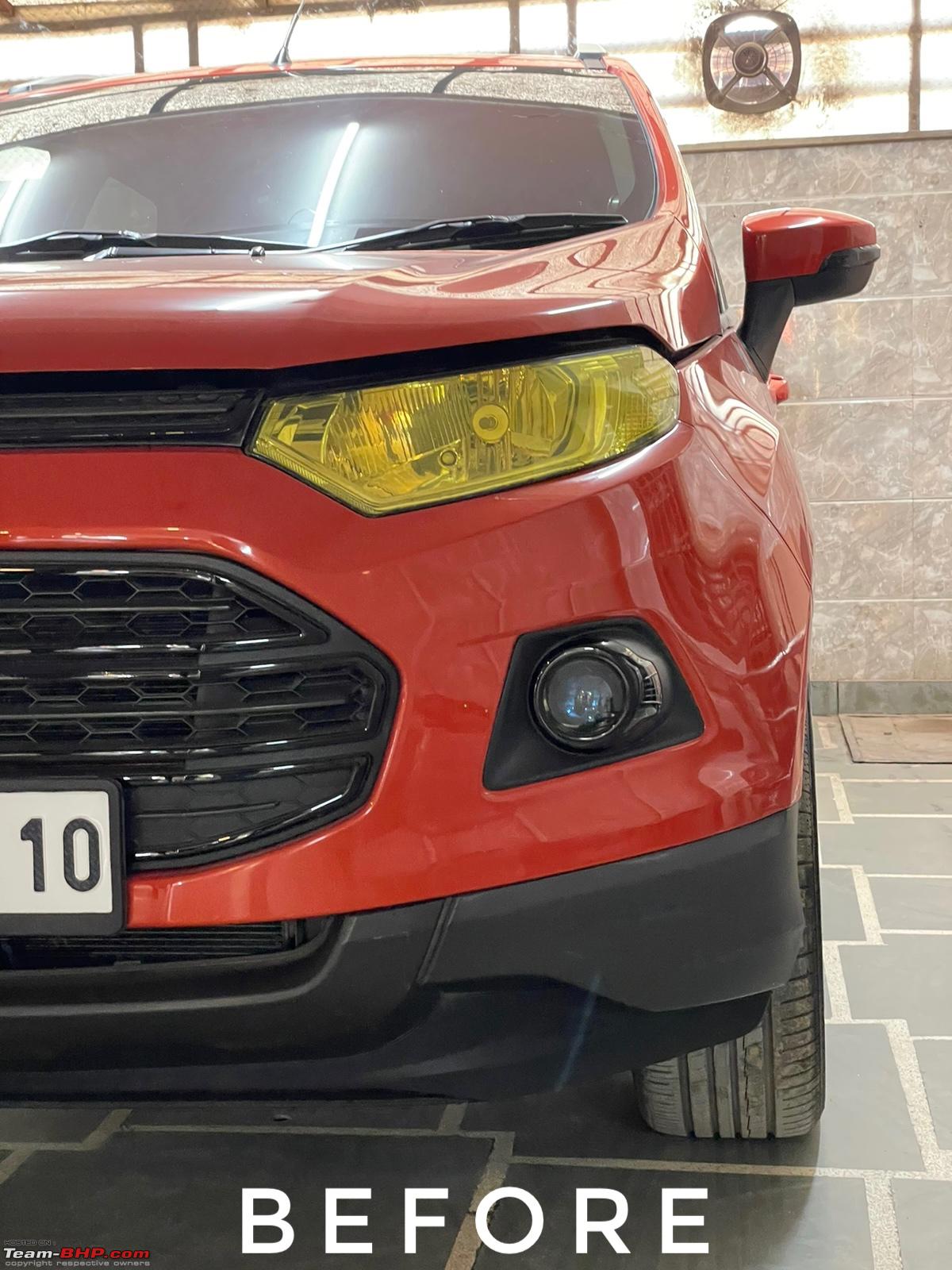

I had been using the F.E Retrofit 50W Bi-Xenon Projector Fog Lamp Kit on my Ford EcoSport since 2019, and while it ran without any issues and had great light output, I was always looking for something brighter.
I had also changed every interior and exterior bulb to LED, so the itch to change the fog lamps to an LED unit was something that I was trying to suppress.
more over, as you can see from my yellow tinted headlights, i’m a sucker for warm white light output, and what made things worse is that every decent LED projector fog lamp was rated at 6000K or above.
fast forward to two weeks ago, a friend of mine who specifically does headlight upgrades told me that AOZOOM was about to launch their brightest LED projector fog lamp, and not only did it come with a laser function, but it was rated at 4300K.
needless to say I was sold, and off I went to get it installed.
for any sort of head lamp or fog lamp upgrade, hit up @HeadlightUpgradeIndia and take my reference!

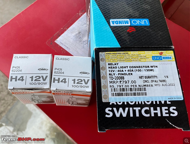

The stock bulbs on my Safari Dicor are 60/55w. My last highway drive from Pondicherry extended to mignight and I was very dissappointed with my headlights.
I went for a replacement and decided to install 100/90w bulbs and Minda relay 100/130w today (based on the suggestion from the shop owner)
I am yet to test the set up during night today, but can anyone tell me if I can also install 130/90w bulb on this set up if I need it?
Is there a difference expected between 100/130w and 130/100w relay?
Please note, I do not drive on high beam with oncoming traffic and 130/90w set up should not be a problem for them.

Saw this post and remembered a similar issue a decade ago when I upgraded SX4s headlight. I too had a relay issue and this showed up right at the start since the relay had a manufacturing defect and would stick to the contacts. When you swap the relay, disconnect the fuse of the headlight and switch between high and low beams 20+ times to exercise the relay. If there are any defects which would cause immediate issues it will show up immediately.
What I would also recommend is to not go for these unheard brands especially for the relay. Back then I had installed a 'Super' branded wiring kit and relay and this relay had an issue. I replaced it with Roots Relay and that has worked flawlessly untill date. The relay coupler is generic so you can swap this Vaishu relay with one from a brand like Bosch/Roots/PMP/Minda etc and is hardly a 200-300 rupee expense for peace of mind.
The H4 headlight wiring kits are normally meant to handle 130/100 watt bulbs at max which is by the design choice of wires and fuses. Its always the high beam which is rated higher so there is no 100/130 arrangement where the high beam is 100w and low beam 130. So you can definitely go with 130/90 bulbs. There is no variant of wiring kit and relay specific to the wattage of the lights.
But personally I have tried this combination with a Hella 130/90 bulb which was the only one available. I didn't find much improvement compared to the Phillips Rally 100/90 bulbs. Hence I reverted to 100/90. I have used Osram/Bosch/Hella and Phillips 100/90 bulbs and can assure you that Bosch and Hella won't give you a significant improvement. Phillips is the best and Osram follows. However at that time I would stick to Phillips since it featured a UV Block glass which would prevent headlight fading. Due to this, the headlights of my car never faded over 10 years.
