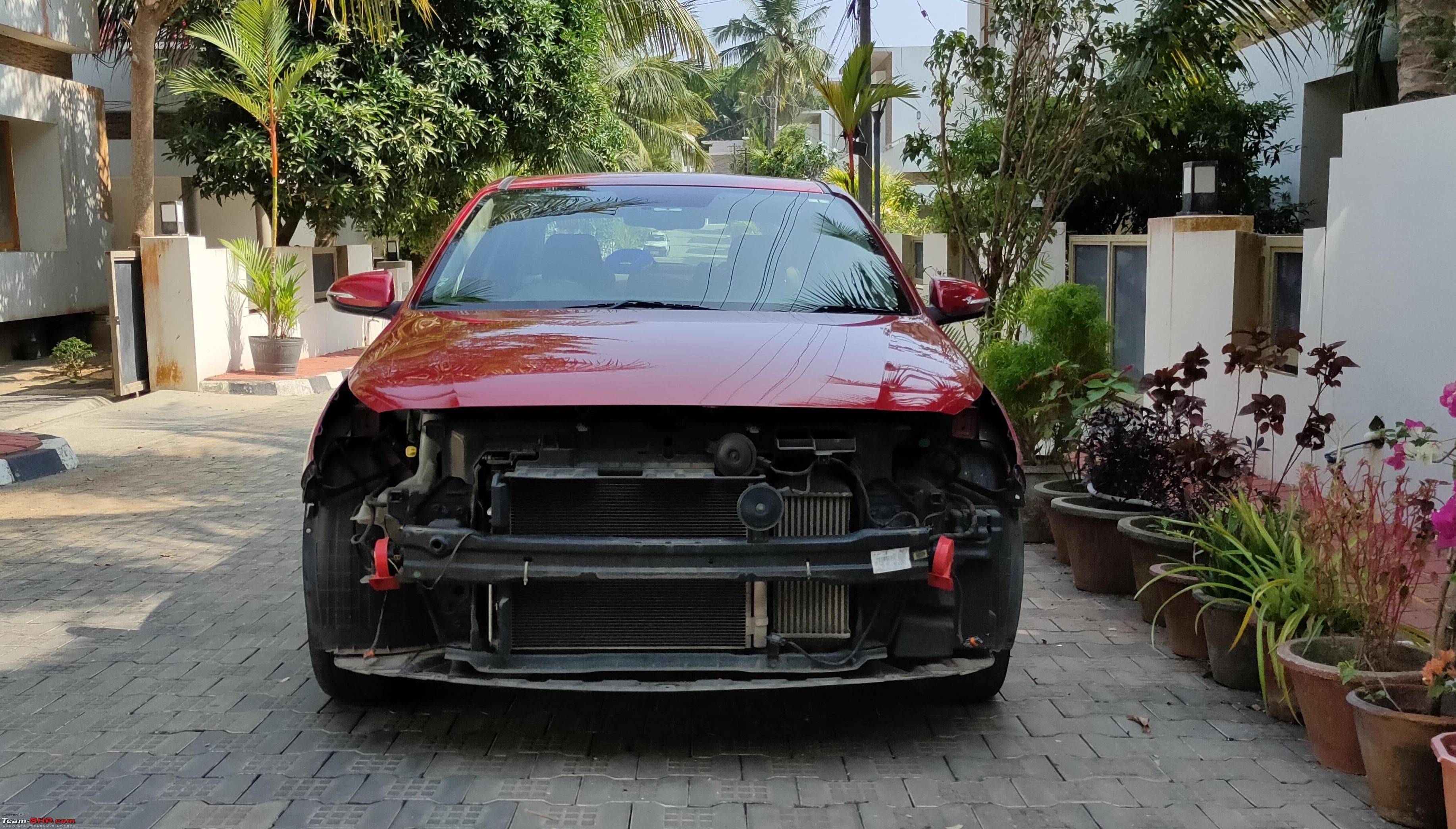

The next task (for Verna) was to remove the bumper and take the whole headlamp assembly out. This is required since it is very difficult to work with the assembly while it is still on the car, owing to the narrow gap at the back of the assembly.
Auto Lighting thread : Post all queries about automobile lighting here-carwthoutbumper.jpg
