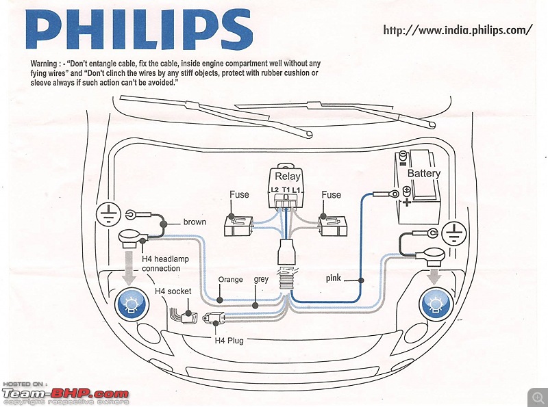

Originally Posted by vinbie2019 View Post
My 2014 Maruti Ertiga stock lights are super dull even with swapped new batteries few months back. Any idea, if above mentioned bulbs and relay kit will work for 2014 Ertiga? I'm asking from headlamp assembly and heating of casing perspective. Also it will be useful if you can mention the accessory store who installed it for you. As i live in north Bangalore, any trustable accessory shop for such work will be super useful
The above mentioned bulbs and relay will suit the 2014 Ertiga. Also note that, my night-drives last only 1 to 2 hours, once or twice a week. And its only low beams most of the time. If you are using for longer hours and constant high beams, better go for 90/100W (https://www.amazon.in/Philips-Rally-...dp/B07Z7R8452/) as per Parag sir (https://www.team-bhp.com/forum/test-...ml#post3871434 (Review: 1st-gen Maruti Ertiga)).
Sorry I am not from bangalore and cannot suggest any stores. I got it done in DIY mode. Hope the image below will help you. Once you get the relay kit you ll be able to figure it out.

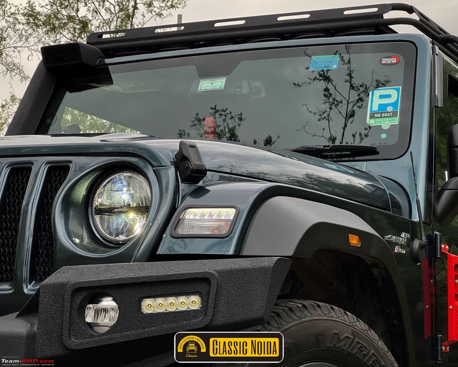

I am also very confused with headlight options for Thar.
I can share my research on this Subject.
New Headlights
- Very Expensive
- Most of them are cheap Chinese copies of Wrangler Lights.
- If you want something reliable then call - Classic Noida, they have Stedi Lights which costs around 50k. They have 5 years warranty.
- As for other options, Bimbra has recently added two more Headlights into their stock. You can see their new Catalogue.
Stedi Lights
Auto Lighting thread : Post all queries about automobile lighting here-ab452e1fc11f42619d2e7f1f23ac86b9.jpg
