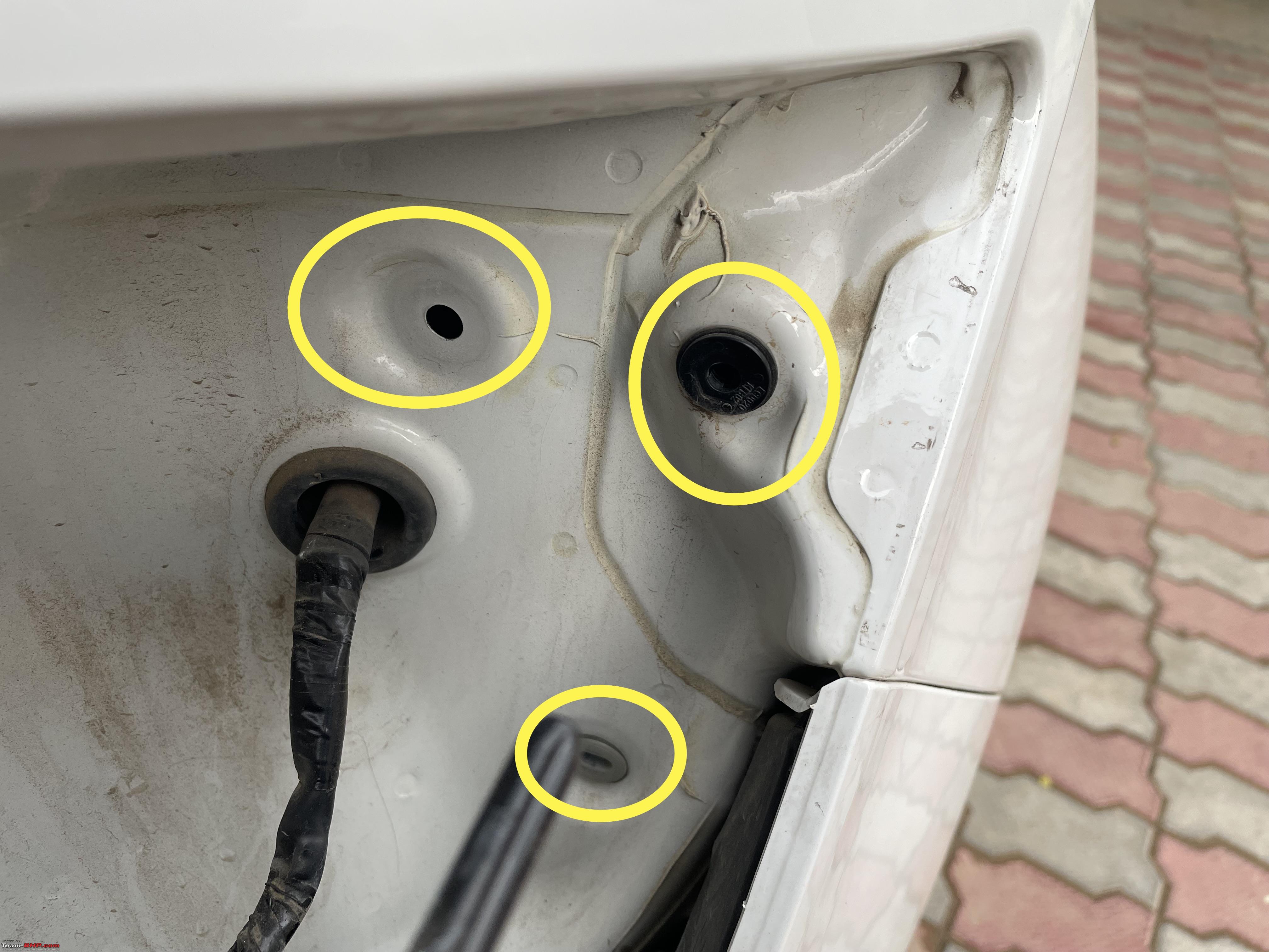

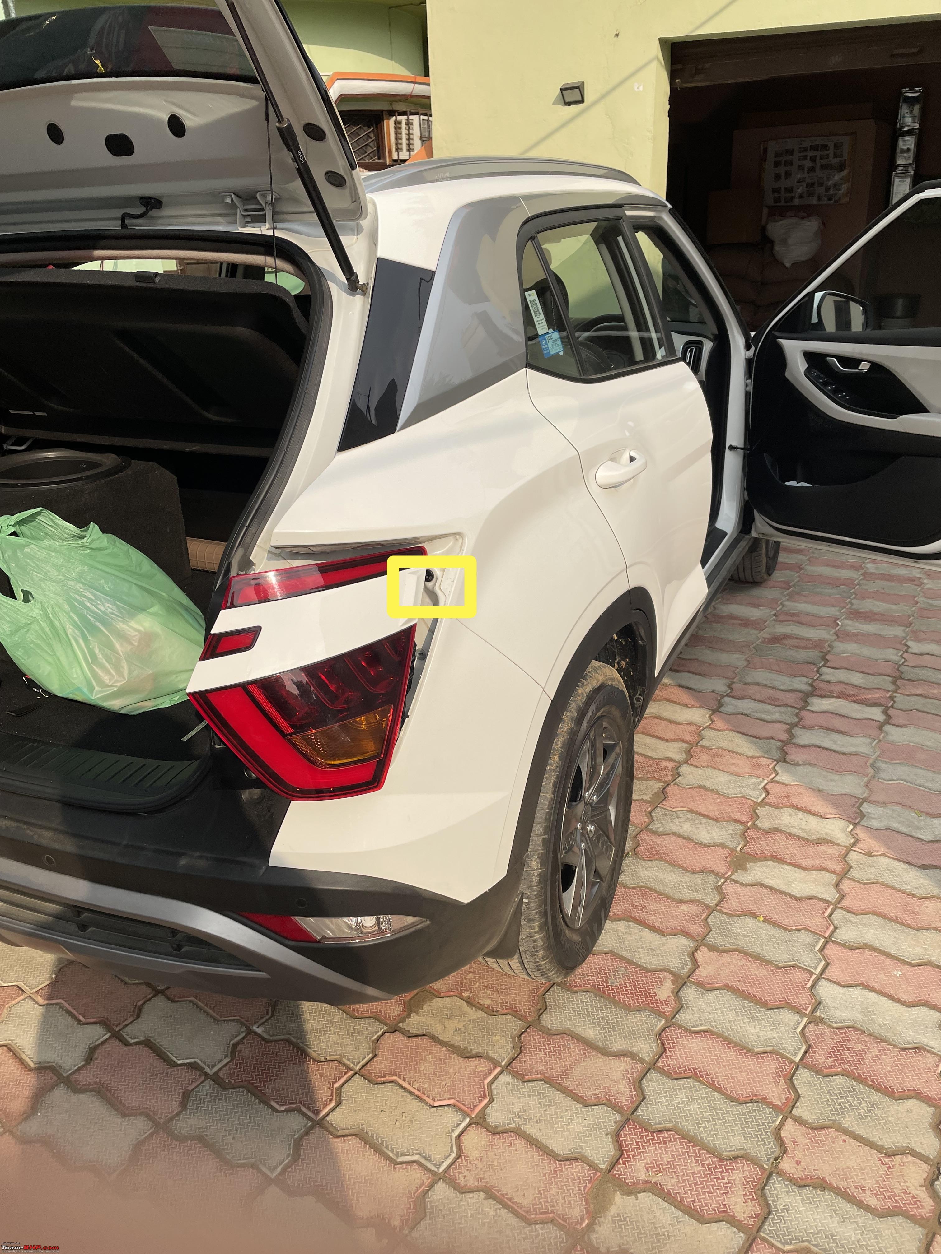

  2. Use Philips screwdriver to unscrew the following screws. Keep screws in the boot or a safe place.

  3. Insert Trim removal tool at the following point. You should be able to insert it for some length(~4-5cm.).
    Auto Lighting thread : Post all queries about automobile lighting here-point-3.jpg
  4. The tail light section is anchored to the car body using the following 3 points. Pull the light out using hands from the section where screws were unscrewed and at the same time apply a little pressure on the trim removal tool to release the locks from the anchoring points. Do not put excessive pressure, it is meant to slide out easily using trim removal tool.
