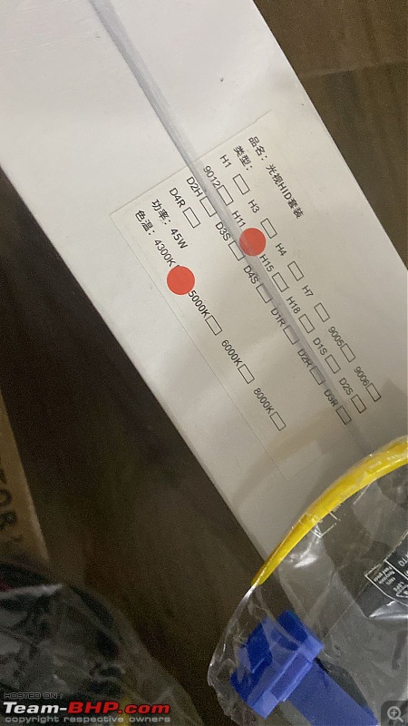

My long pending itch to do something new on my 6 year old car led me to ordering the 4300K GS HIDs from BlazeIndia. This was motivated by the same bulbs on the Nexon of Reinhard. I had earlier ordered some 4300K LEDs from Aliexpress but unfortunately the results were pathetic and hence gave up on LEDs.
Installing the bulbs was a 10 min job, and the results are awesome! My car has a projector low beam and this is one upgrade that i will recommend to everyone running low-beam halogen projectors. HIDs achieve full brightness in about 15-20 secs and the projector ensures absolutely no glare. An absolute WIN-WIN.These 4300K HIDs do look pretty white, only when compared directly with a 6000K setup, do we realise that they sit nicely between the Halogen & the LED colour temperature.
I'm also looking for recommendations for LED festoon bulbs for roof lamp, but anything from reputed manufacturers are simply not available on Amazon.
