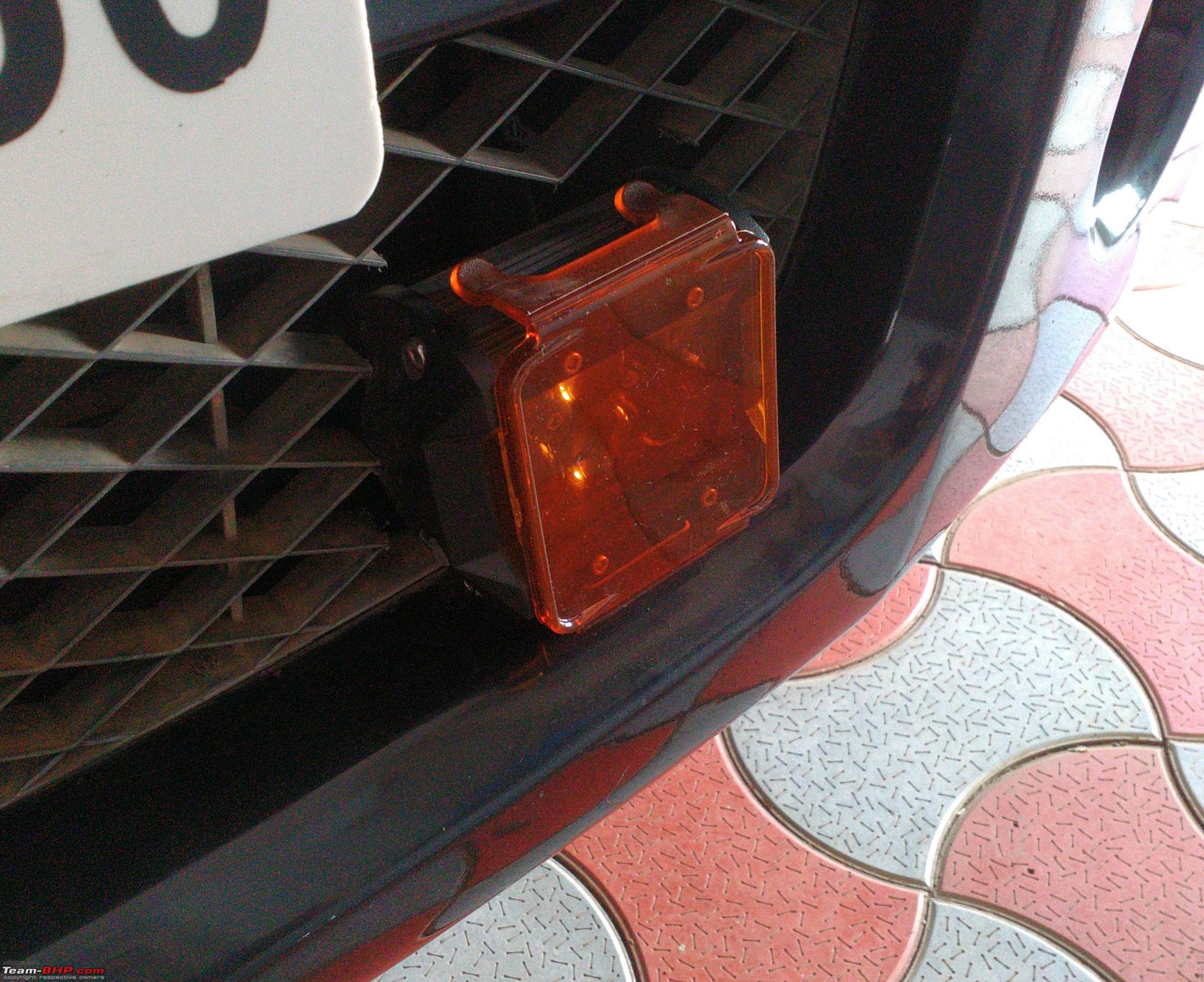

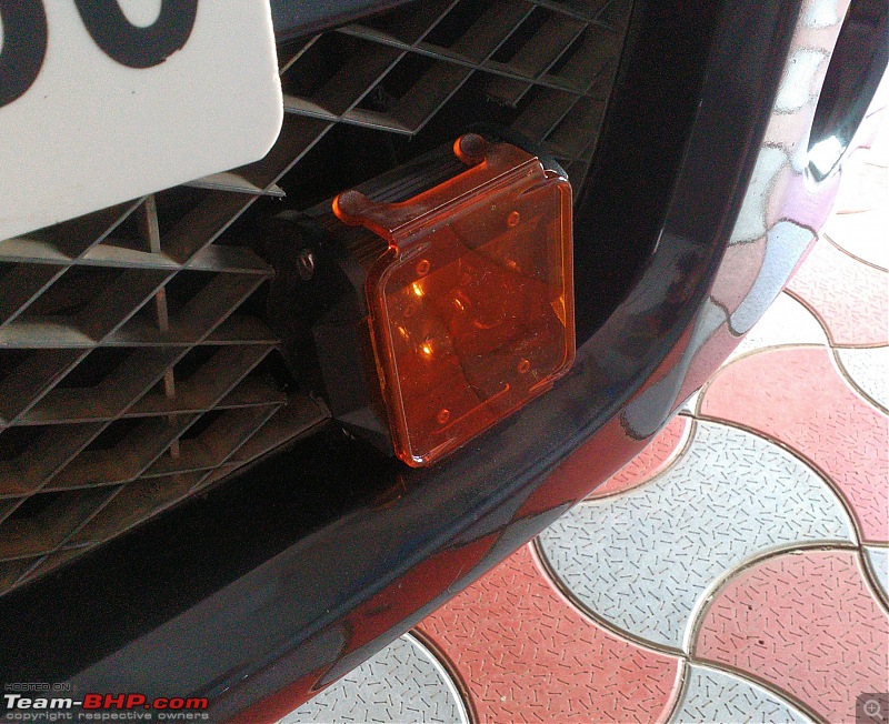

Dear All, need some suggestion regarding the illumination of my XL6.
While I'm satisfied with the throw of HL on normal days, visibility in dense North Indian fogs is downright crappy, thanks to white illumination from all LED setup. Memories of last year's drive still haunt me, and it all came back when I had to drive in that dense fog few days back. My visibility was horrendous, barely 5m ahead of me. I nearly missed crashing into a divider, even at 20-30kmph speed.
I have a multibeam setup on my Grand Vitara as follows:-
1. HB3 halogen reflector high beam - 60W*2. I guess 2700-3000K colour
2. H7 HID projector low beam 4300K - 35W*2
3. H11 Fogs with led bulb in reflector - 4300K - 20W*2
4. Pair of LED cubes on bumper - adjusted to illuminate from 35 to 50feet in front of the car. With Amber cover. 20W*2 I guess 2700K colour.
In 2018 I spent a couple of days in Amboli during the monsoon peak. We stayed in a resort that was accessed through a narrow road passing through the dense forests. And needless to say there was very very dense fog and rain all the time.
I found that all the lights were pretty much useless in the fog. So I used to drive very very slowly. And was quite liberal with the horn.
Of all the various beams i found that the Halogen High Beam was the most effective in piercing the fog. But at no time was visibility more that 10-15 feet.
Your best bet would be to get a pair of Reflector type Halogen Spot lamps - 55W or 90W bulb. Add a yellow cover if at all you need to.
Mount them in the top of the bumper and adjust them to throw at a distance of 50-80 feet. And cover them with black rexine for normal days.
