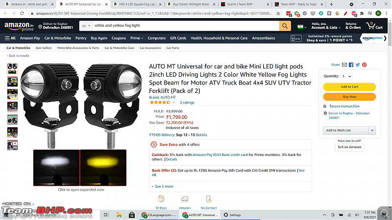

3 LED lights which can go yellow and white: Numerous chinese ones, but hey , they go from yellow to white and viceversa at a flick of a button. Will have to go to a local accessories market at night and pick a pair after testing. Cost: Rs 2000
Auto Lighting thread : Post all queries about automobile lighting here-screenshot-414.png

Any idea about the HJG lights I have posted in my revised post. At Rs 3000, they look pretty useful for my purpose.
3 I was talking about LED fogs. Have a look at my revised post.
Have tried 100/90 bulbs setup twice. This was with original Hella/Phillips harness and relay. Tried both phillips/osram rally bulbs with the same. After multiple bulb failures, ended up throwing the entire thing. Repeated the same after some time and have recently thrown them away few months back. I know it must be running perfectly in some cars, but it does not suit some cars. I have had a similar experience in my bro in law's santro. By the way both times used them for a year at least and there was nodamage to reflectors.
Saw your revised post with the pictures. I do not recommend the LED fogs you have posted. They will not solve your problem as they are SPOTS. What you need is a wide beam bright light.
You can take a look at the Hella Light Bar 470 review (Hella Light Bar 470 Review) posted by Stribog. Maybe this might solve your problem without touching the original headlights.
