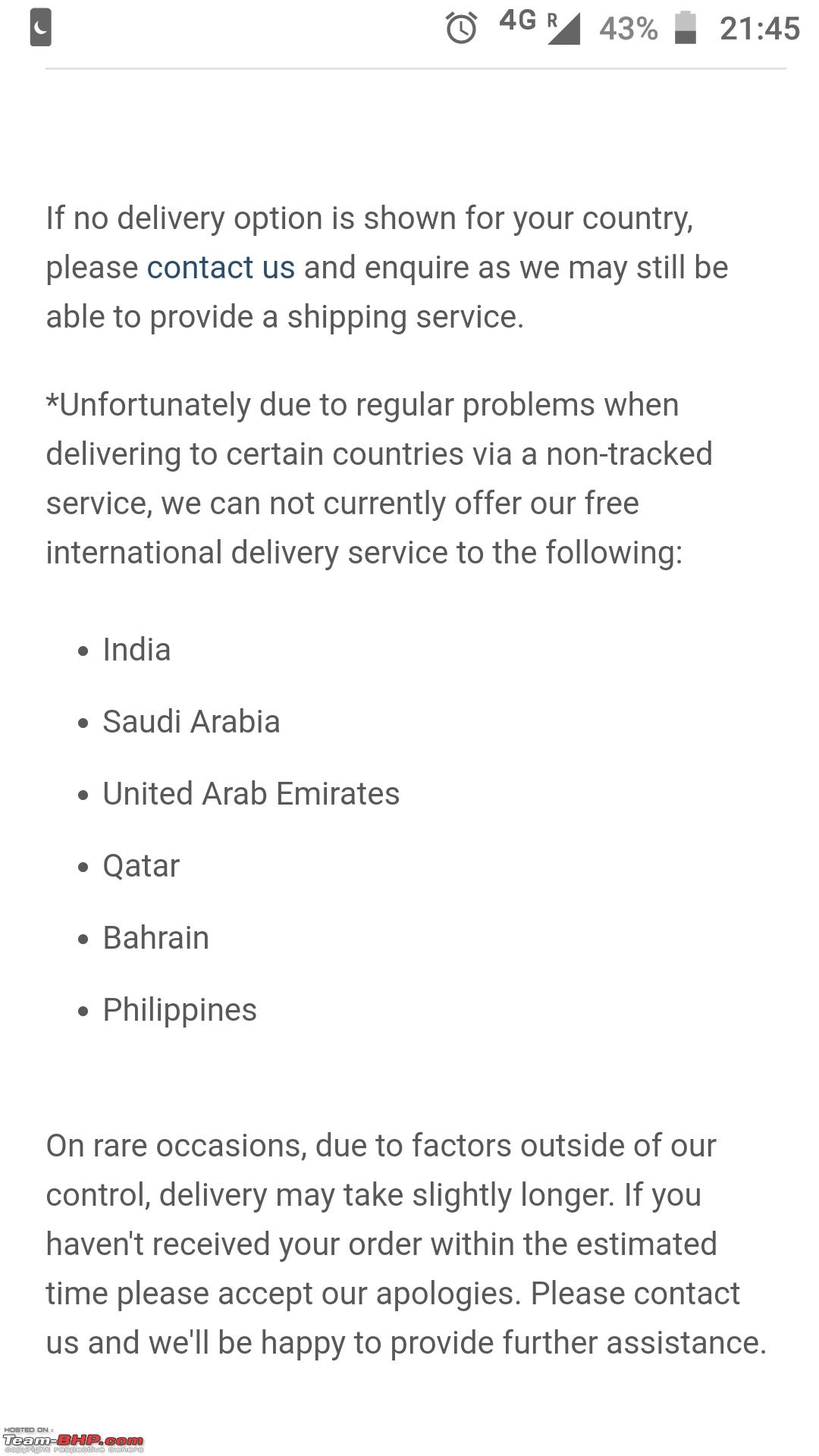

Powerbulbs stopped free shipping to India sometime ago and charge close to 8 pounds for shipping.
Auto Lighting thread : Post all queries about automobile lighting here-screenshot_20190108214519.png
