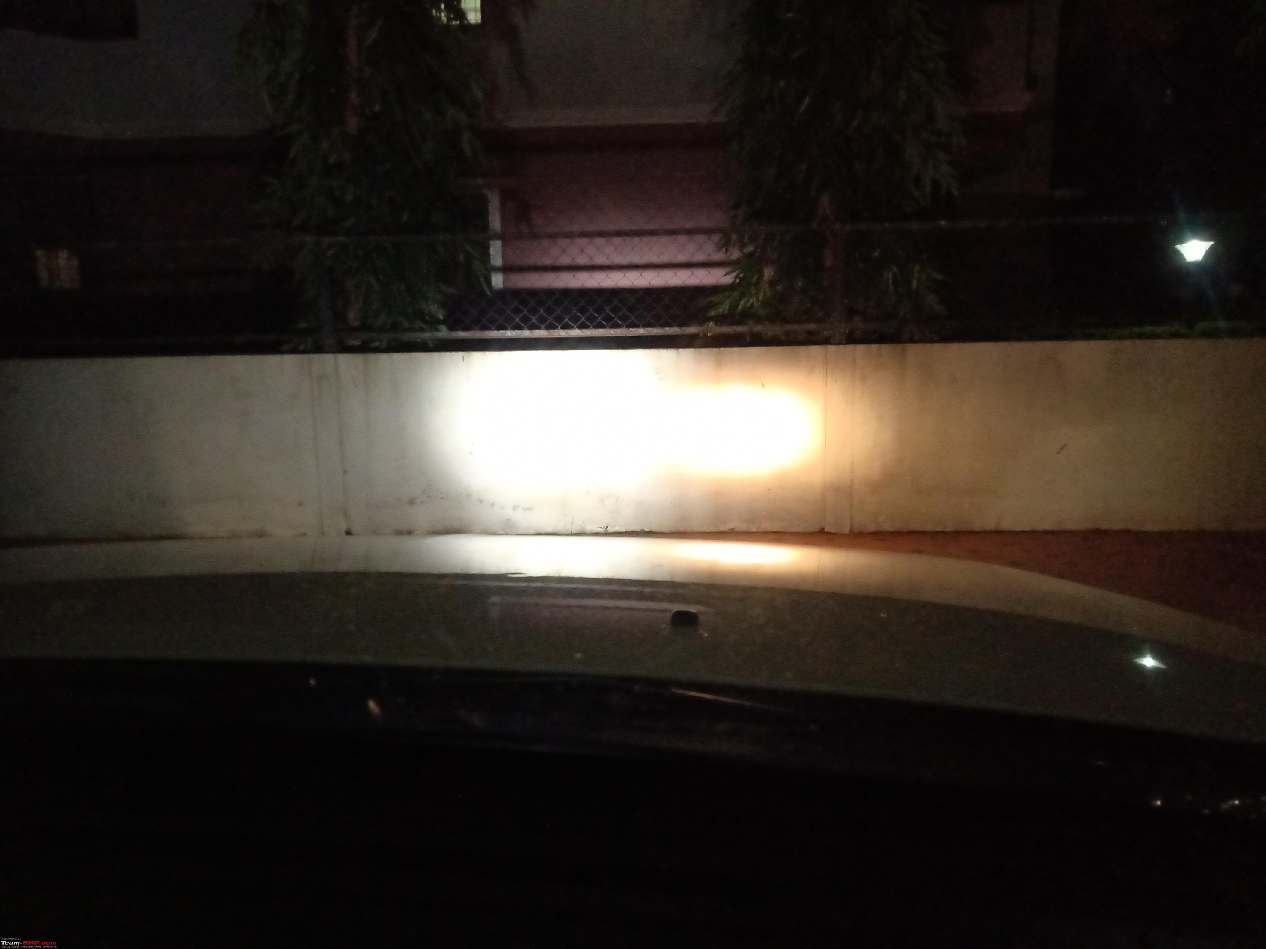

An update on this bulb. I got it last week and installed over the weekend.
Like mentioned earlier, I had already tried out regular LED headlights (XHP-50) but stopped using it due to the scatter and lack of focus of the light beam. Since CSP LED chips were supposed to be better at focus, tried this out and in theory, CSP chips on all 4 sides meant no gaps. But while it is better than regular LED, it still lacks focus like Halogen and will blind oncoming traffic, though to a lesser degree than XHP-50. These bulbs are bright, easily twice as bright as H9 halogen 65W. It uses much less power (around 20W) and runs much cooler than the XHP-50. The fan is bit noisy though and can be heard inside the car with engine off.
Packaging not as good or premium as the earlier XHP-50 bulb.
Auto Lighting thread : Post all queries about automobile lighting here-csp-led-4-6.jpg
The 4 side CSP LED Bulb
Auto Lighting thread : Post all queries about automobile lighting here-csp-led-4-7.jpg
Left is XHP-50 LED, right is H9 Halogen
Auto Lighting thread : Post all queries about automobile lighting here-csp-led-4-1.jpg
Left is 4 side CSP LED, right is H9 Halogen
Auto Lighting thread : Post all queries about automobile lighting here-csp-led-4-2.jpg
Only Left side is on, low beam plus 4 side CSP LED
Auto Lighting thread : Post all queries about automobile lighting here-csp-led-4-4.jpg
Only right side is on, low beam plus Halogen
Auto Lighting thread : Post all queries about automobile lighting here-csp-led-4-5.jpg
Overall impressions:
XHP-50 puts out more light
4 side CSP is close but less output, slightly better focus and more reach than XHP-50
Halogen still is better wrt focus and reach
I need to try and find one which best suits my cars reflector. Will try the regular 2 side CSP next.
