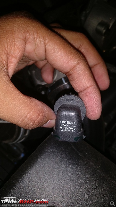

Anyone knows the bulb type for fog lamps for a 2015 Grand i10? The manual strangely does not mention what type of bulbs are used and only mentions its a 27W one. I am ordering some LED ones so want to be 100% sure before spending 1.5k.
It is H27 type or 881 type.
Auto Lighting thread : Post all queries about automobile lighting here-img_20171030_002149768x1365.jpg
Look for 881 type bulbs when you search for LED's.
Attachment 1811890
Thanks anurag, since you seem to have replaced yours once can you confirm if there is enough space behind the bulb to accommodate the LED ones with heatsink sticking out the back ?
There is space behind the fog lamp unit in the Creta so it can accomodate an LED unit.
I have gone for LED + DRL in my car. Output of the fogs is useless though, it is only for the DRL that I've fixed it, don't use fogs.
