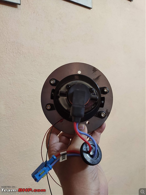

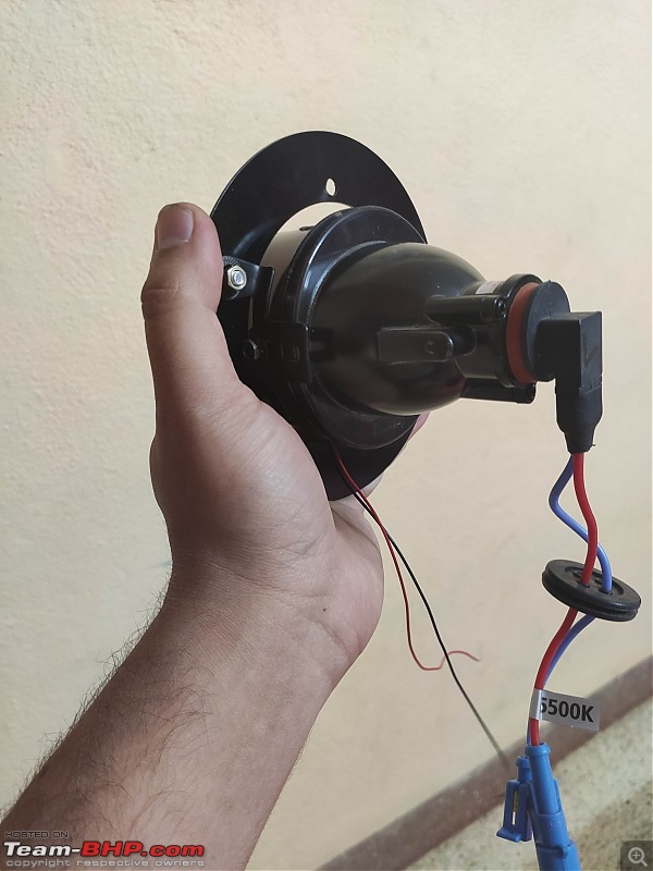

I had decided that I could no longer live with the stock fiesta headlights, the low beam was of no use, despite a recent upgrade to Osram Halogens . I had done a bit of research and decided to go with Projectors and after reading reviews here, I placed my order with Blaze India.
When communicating with Blaze, there are 2 WhatsApp numbers, one managed by the owner Amit and the other by his sales team, after transferring the amount there was no response from the seller, for close to a week, I looked up other available numbers and reached out to Amit, who apologized and shipped the consignment the same day. I paid 7.5K for the Non-Canbus type.
These are all the components the Projectors ship with.
The 3 Inch Projector, were shipped with Bulbs inserted
Auto Lighting thread : Post all queries about automobile lighting here-projector.jpg
Harness to connect the HID to Car Fog Wiring
Auto Lighting thread : Post all queries about automobile lighting here-harness.jpg
Ballast
Auto Lighting thread : Post all queries about automobile lighting here-ballast.jpg
Zip ties - 2 Green Light ties and 4 white ties heavy duty for mounting the ballast
Auto Lighting thread : Post all queries about automobile lighting here-zip-ties.jpg

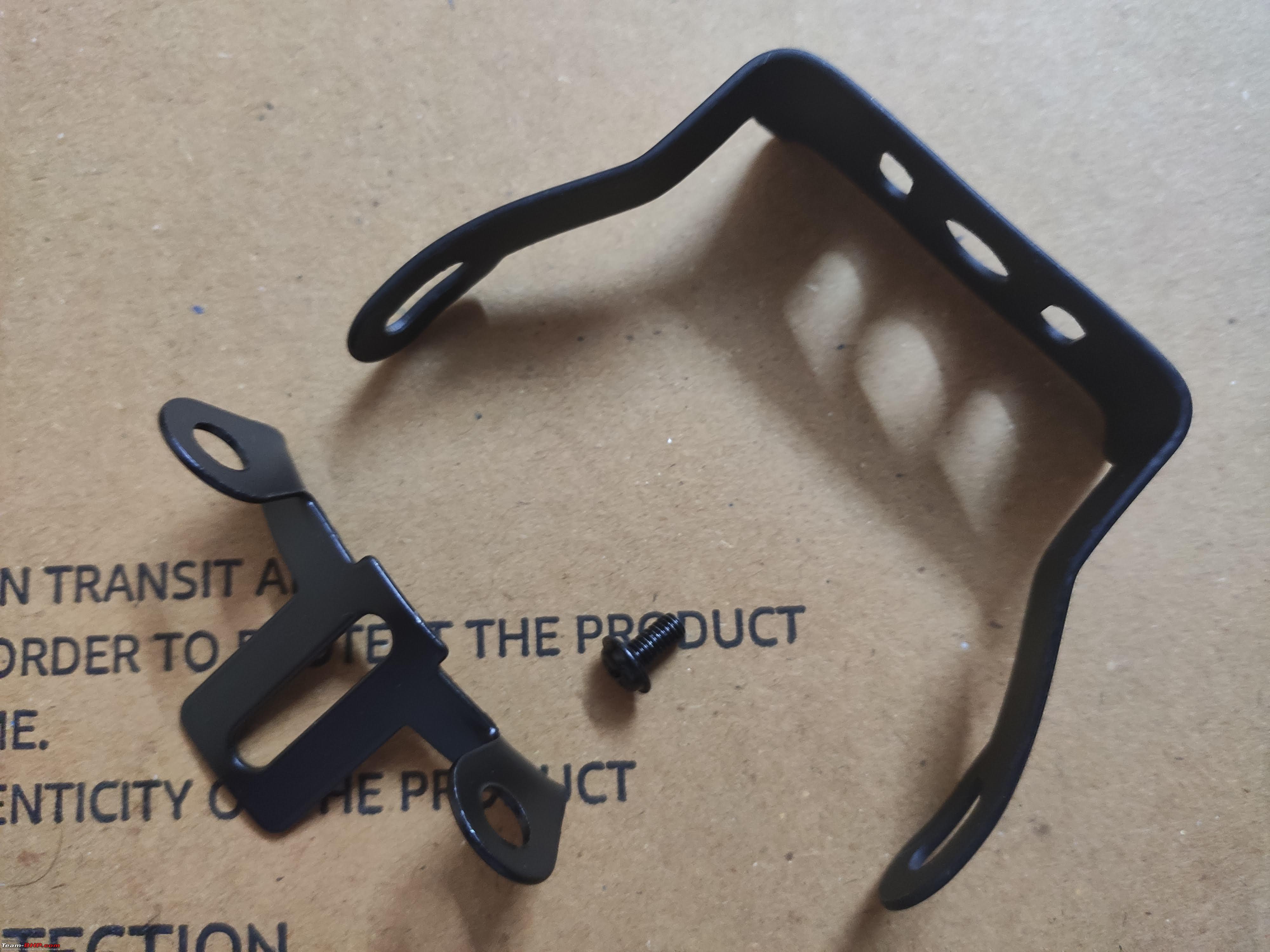

4 butterfly type bracket and 2 hanging type bracket.
Auto Lighting thread : Post all queries about automobile lighting here-hanging-bracket.jpg
I had been looking for an installer for some time, I was in Hubli and there were no installers with experience with projector Fog lights. I finally found a guy who said he had done it before and I went ahead with him. I had couple of assumptions
1. The Stock Fog lights bulbs are H3, I made a Piggy to hook up the HID kit to stock harness, I got 2 Uno Minda H11 Connectors
2. The Bracket set provided with the IPH car projector would work with my car, since I was told it was universal
3. The installed would do a decent job if I agree to pay him a bit more.
Uno Minda Connector
Auto Lighting thread : Post all queries about automobile lighting here-uno-minda.jpg
I did not want a jugaad of an install on my car and which is why I thought my research would avoid it. All 3 assumptions were proven wrong.
Install day –

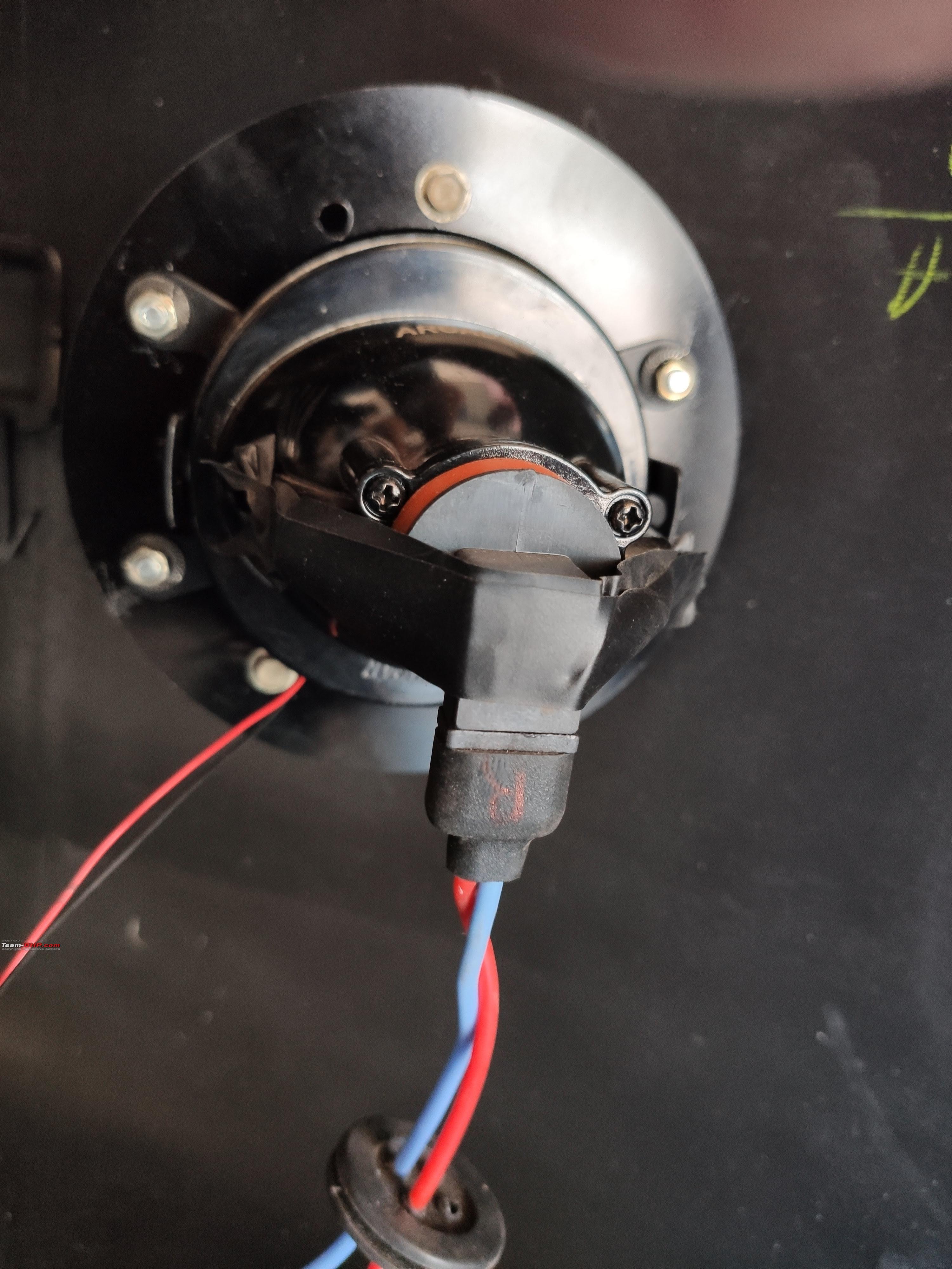

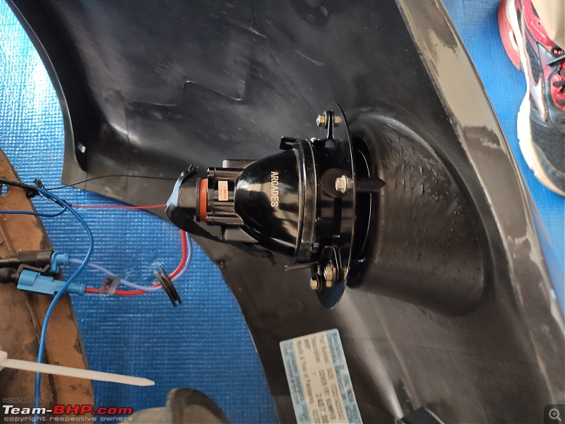

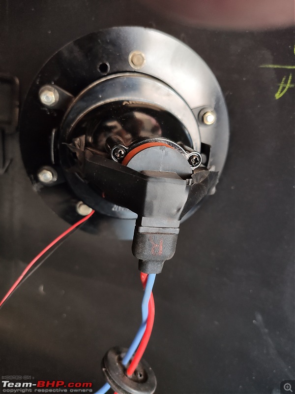

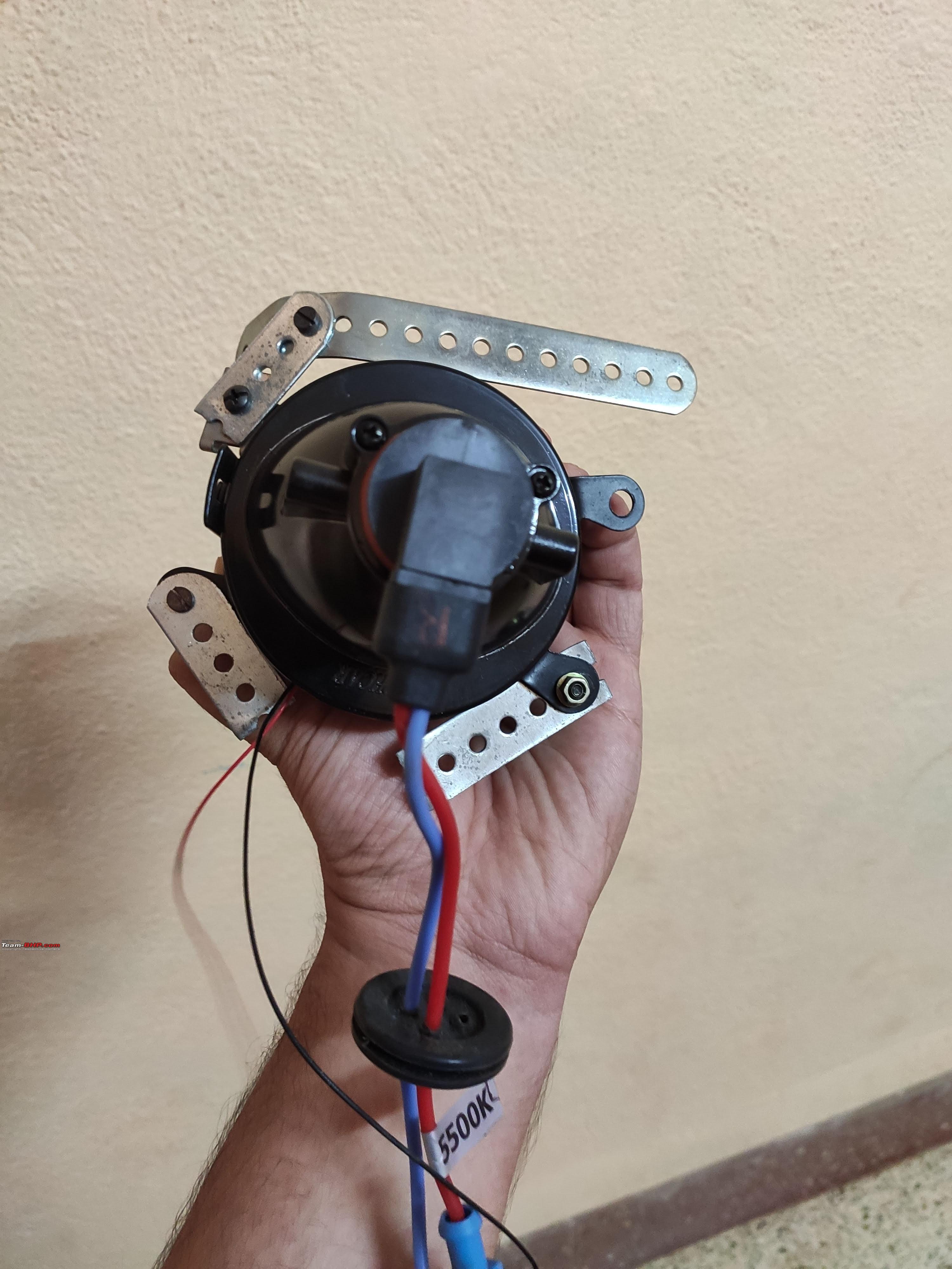

The Fiesta fog lights has 3 mounts, with 1 on the top and 2 at the bottom, we tried a few permutations to fit it, there was just no way to fit it. And all I could so was watch the installer do the jugaad I did not want to do. I do not blame the installer in any way, this was purely a result of my lack of proper research.
This is how it was mounted, I really hated it. I had to pay the installer and till I figure out a proper install, I can test out the systems.
The Stock Fog has 3 mounting points, 1 on top and 2 at bottom, the brackets shipped with the kit was not adaptable
Auto Lighting thread : Post all queries about automobile lighting here-attempt-1-bumper.jpg

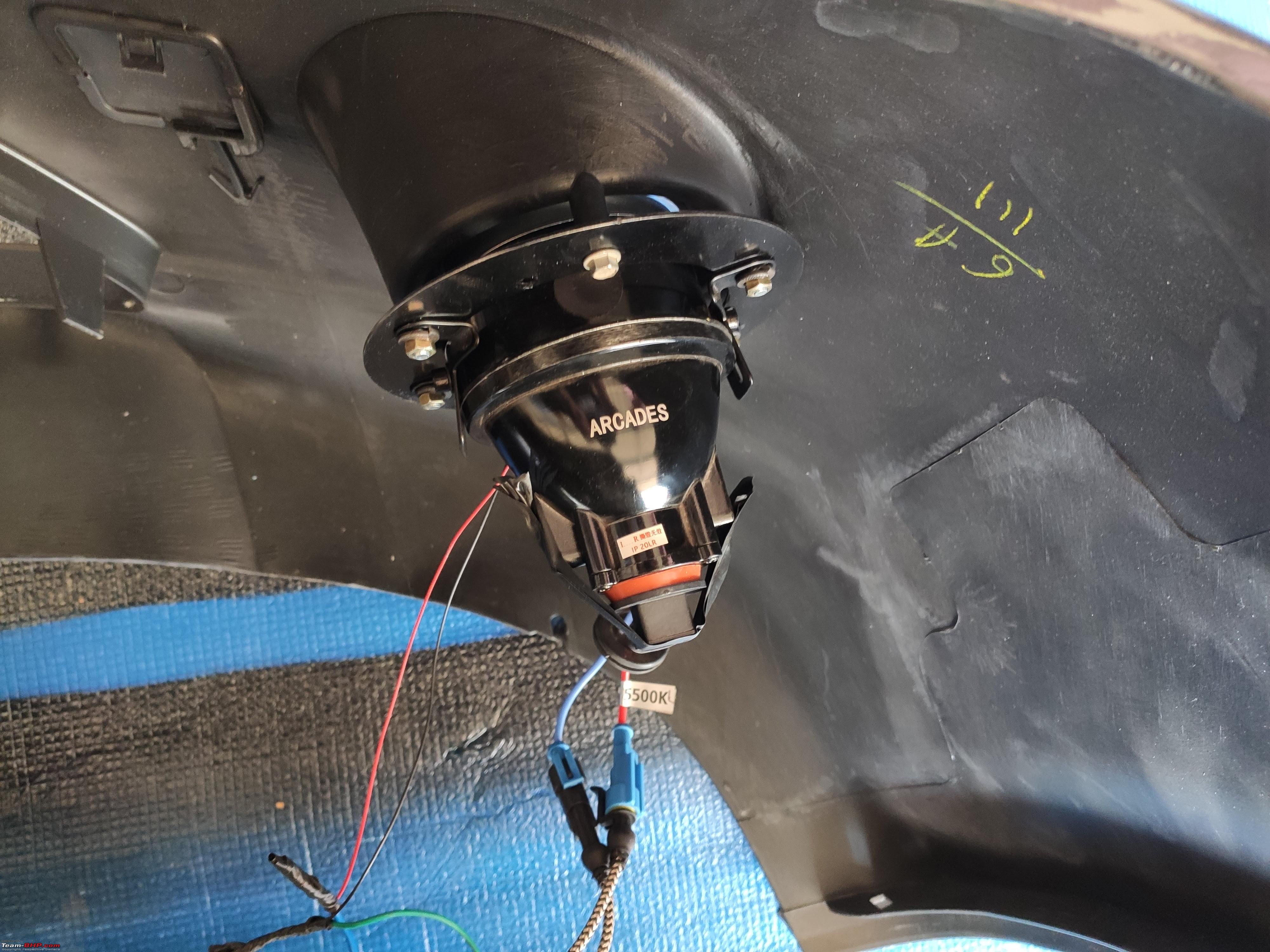

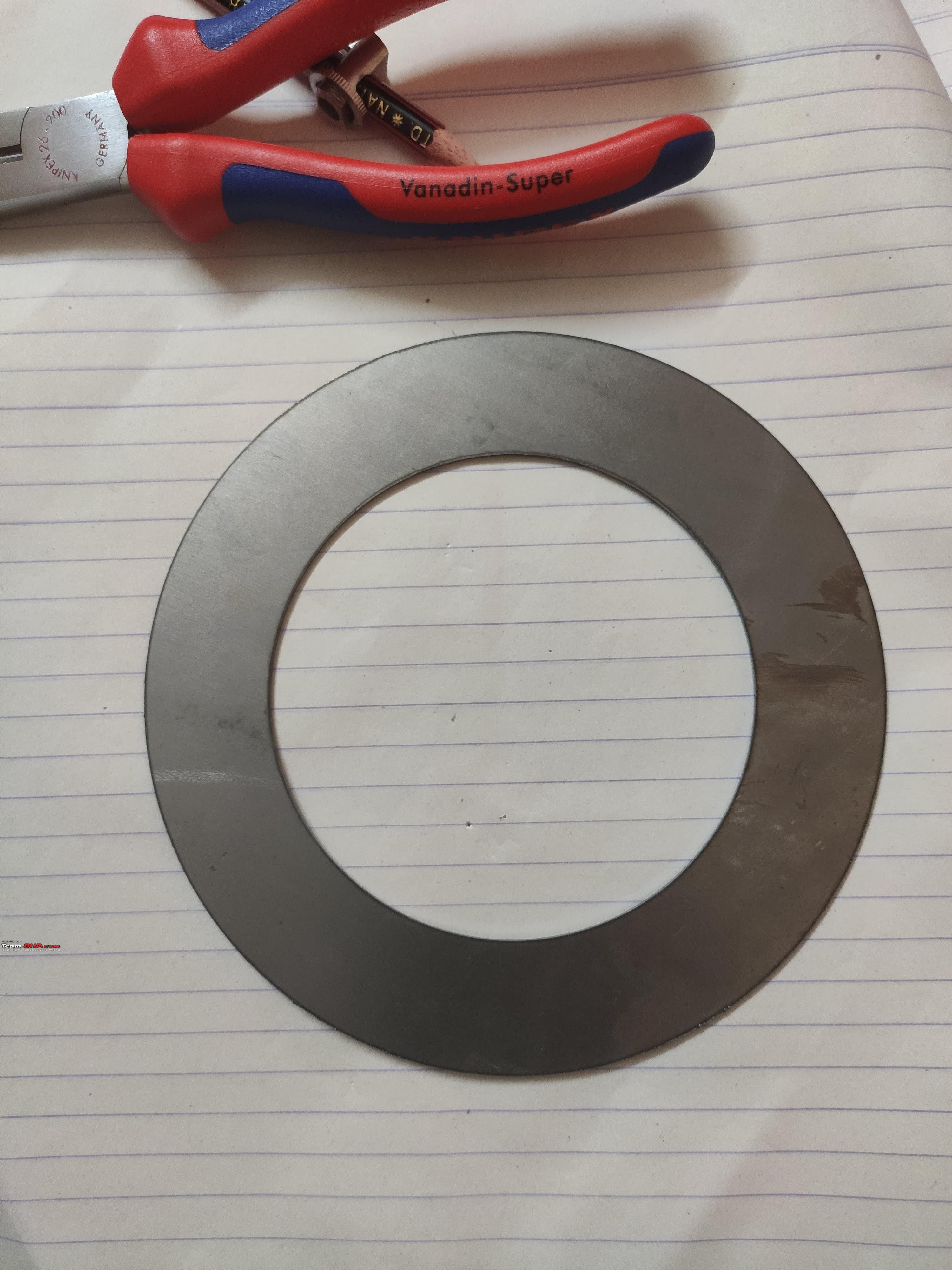

Went back to the drawing board, made a adapter template using the stock Fog light brackets, triangulated the mounting points came up with the below.
I went back to YouTube and saw how this was installed in other cars, and not surprisingly, it was Jugaad in most, Maruti Swift and Ford Aspire can use the universal bracket
Went to a local fabricator who said, he could cut it, but the finish would not be great, I was looking around his shop and found a 16 gauge sheet metal plate, which I thought would make a good adapter base, paid 100 bucks for it.
Went looking for a Lazer cutting unit, I was told I would need a CAD file to give to the Lazer unit, luckily the shop made my template in Auto Cad and cut it for me, paid 70 Rs for it.
Auto Lighting thread : Post all queries about automobile lighting here-laser-cut-adapter.jpg
I also went to the local hardware shop and purchased half inch nut and bolt with spring washer, I got 12 Nut, bolt and spring washers paid 42 Rs, I did not have an Allen key set, paid 210rs for a Taparia kit.
Auto Lighting thread : Post all queries about automobile lighting here-nut-bolts.jpg
Once I had the adapter, I drilled holes to match the mounting points for the bumper and then for the Projectors.
Checking the fit.

Auto Lighting thread : Post all queries about automobile lighting here-adapter-test-fit-2.jpg
All painted, to protect it from rust.
Auto Lighting thread : Post all queries about automobile lighting here-adapter-painted-fit-1.jpg
Auto Lighting thread : Post all queries about automobile lighting here-adapter-painted-fit-2.jpg
Removed Jugaad in hand
Auto Lighting thread : Post all queries about automobile lighting here-jugaad-hand-1.jpg
Auto Lighting thread : Post all queries about automobile lighting here-jugaad-hand-2.jpg
Auto Lighting thread : Post all queries about automobile lighting here-jugaad-hand-3.jpg
Attempt 2
Mounted it on the bumper, and wired it up.
Auto Lighting thread : Post all queries about automobile lighting here-adapter-bumper-1.jpg
Auto Lighting thread : Post all queries about automobile lighting here-adapter-bumper-2.jpg
Auto Lighting thread : Post all queries about automobile lighting here-adapter-bumper-3.jpg
I am satisfied with the mounting, I can live with the wiring.
