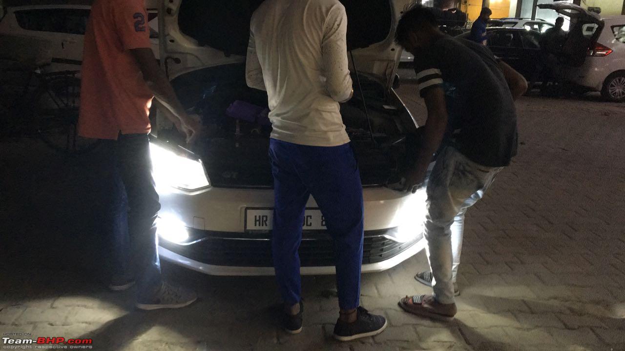

Hey, I have ultinon on high and low beams and on the fogs too. The dust caps fit perfectly. You can fit them without any issues.
I can send fitment photos if you want.
Attachment 1819495
Sir you have rescued me from the abyss! I would be very grateful if you could share some pixtures.
Also, how are the lights performing ? I think aesthetically they are amazing to look at it definitely adds a different look to the car.

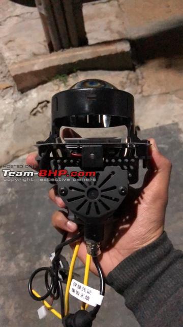

So, I got these LED Projectors from AliExpress. This is the iLens Bi-LED Projector that Morimoto brands as "Profile". The advantage is instant startup and lesser power draw. Fantastic on-road lighting. Flashing will make most people get off the road/dip their beams. This goes right up there as one of the best along with the mini d2s 4.0.
Retrofitting these projectors isn't as simple as a bulb change. So after numerous hesitations, I was like "What the hell, let's just go for it."
Now, let the pictures do the talking.
Auto Lighting thread : Post all queries about automobile lighting here-246ecca79a3d4df6ad5d5a8775b89b6d.jpg
BiLED Projector from iLens
Auto Lighting thread : Post all queries about automobile lighting here-img_9782.jpg
Packaging contains the projector, rings and locking nut, screws, led drivers and brackets for mounting.

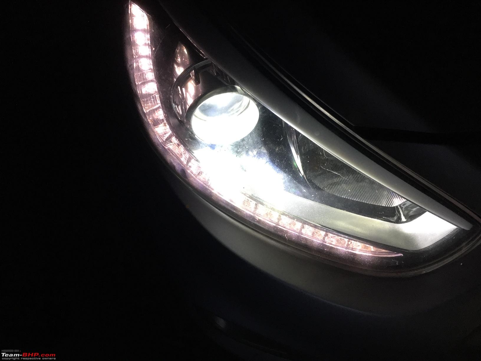

Bi-Beam LED projector screwed in along with the supplied brackets. Had to file off two small points to get the projector to sit in the right position.
Auto Lighting thread : Post all queries about automobile lighting here-img_0225.jpg
Checking for alignment before sealing the headlight back.
Auto Lighting thread : Post all queries about automobile lighting here-img_6082.jpg
Headlight before the retrofit
Auto Lighting thread : Post all queries about automobile lighting here-img_5477.jpg
Headlight after the retrofit.
Unable to upload the cutoff pictures. Will upload them tonight.
I mainly drive in the city so the low beam + fog lamp will give great illumination.
Regards
Hi sir
The lights are doing great, they need additional adjustment which any installer can provide. Attaching throw photos.
