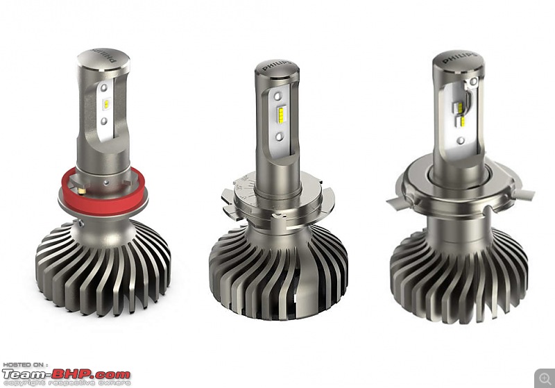

Philips LED headlight bulbs generation 2 are available now.
The LED chips used are Lumileds Altilon, which are OEM grade lighting chips.
https://www.powerbulbs.com/us/produc...-bulbs-h4-twin
https://www.powerbulbs.com/us/produc...-bulbs-h7-twin
Auto Lighting thread : Post all queries about automobile lighting here-philips.jpg
Wow, these are insanely expensive for LED bulbs considering my Gen1 are 7000 a pair!
Can we directly replace h4 bulbs with this?
The generation 1 bulbs come in 2 variants. The Xtreme Ultinons, and Ultinons, which have lesser luminosity than the former.
Yes, they are direct replacements.

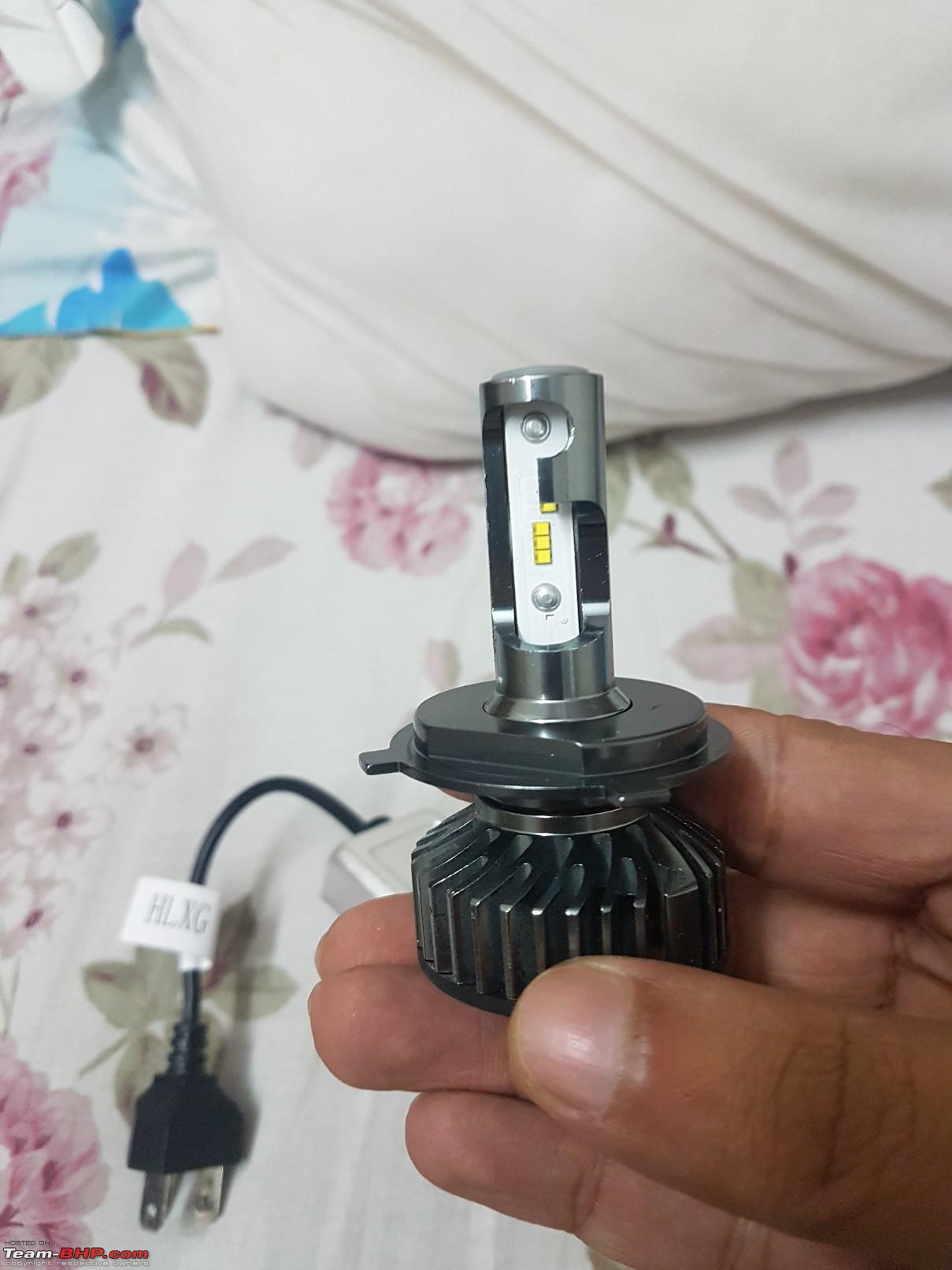

So i ordered a pair of H4 LEDs without doing much research. I should have ordered LEDs closest to the Philips and other similar design LEDs but hurried in ordering these. As expected the high beam output is especially not that good. However i would like to compare these with the Philips H4 design leds to see how much better are the Philips H4s. Any owner of the same H4 Ultinons by Philips in his car around Gurgaon who would like to compare for educational purposes?
Attached are a set of output pictures along with a pic of the bulb itself.
