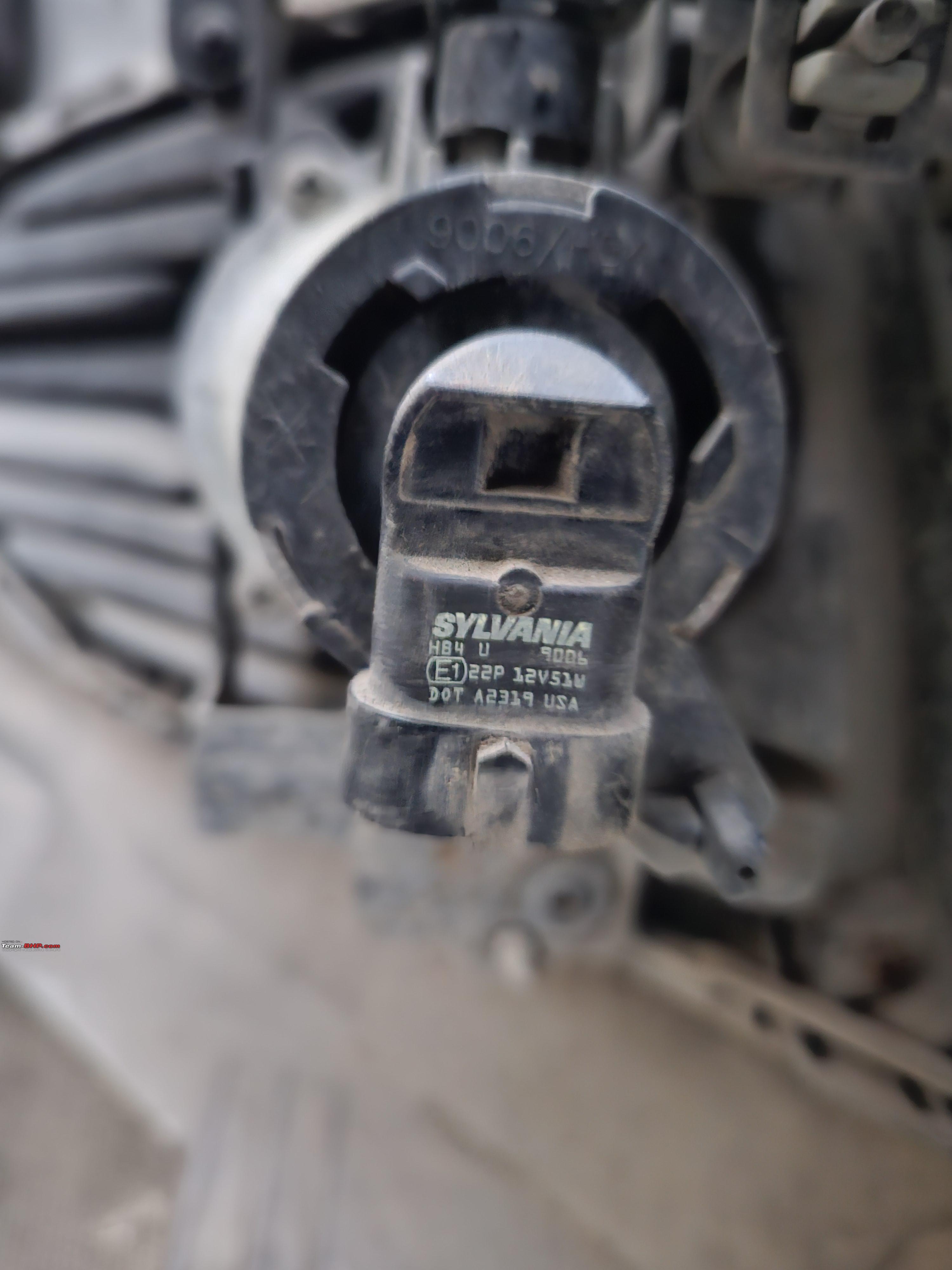

I have been trying to find out the type and wattage of the fog lamps used in my 2018 Verna SX. The owners manual has no details on any of the bulbs fitted in the car. On one website it says h27 and another site says hb4. I was hoping someone here could help me out.
Hi,
Verna 2018 used H27/881 type bulb in fog lamps & the wattage is 27W.

Old 3rd December 2024, 23:25   #12757
Rshrey22's Avatar
Join Date: May 2017
Posts: 372
Thanked: 730 Times
Originally Posted by NA-driver View Post
Hi,
Nope, it's HB4 51w Sylvania. Mine is 2019 model with projector foglamp. I guess same as yours

Old 3rd December 2024, 23:48   #12758
suv100's Avatar
Join Date: Aug 2008
Location: Calicut
Posts: 136
Thanked: 30 Times
Thanks a lot for your reply. Which led bulbs would you suggest as replacement for the Sylvania halogens? I was planning on installing Osram 50w 4200k but not sure if it would be a proper fit.
