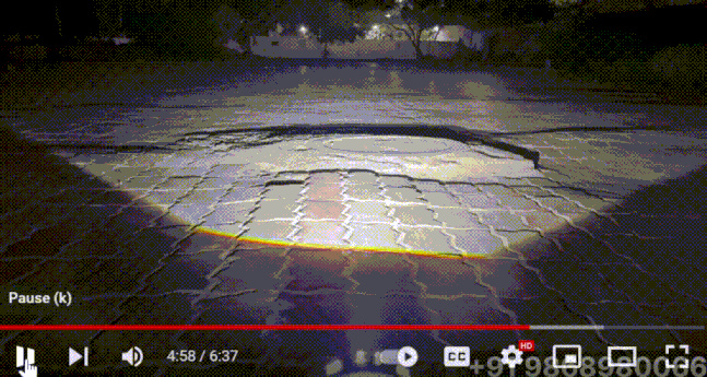

Was just browsing Youtube and saw an interesting lighting product by AES. After tri color fog lamps, now headlamp projectors are also coming with tri colors. So all those who enjoy yellow light now have another option in headlamp retrofits.

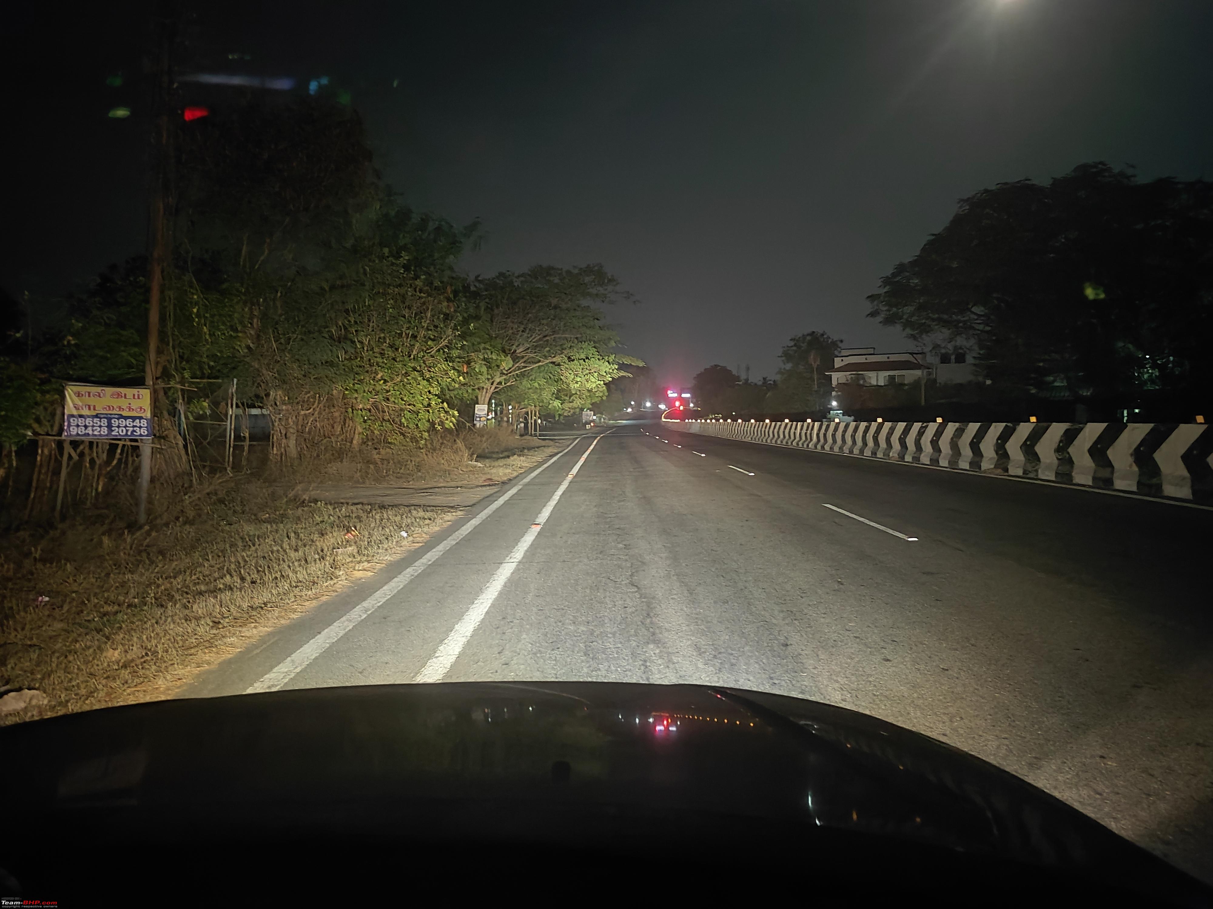

I have recently upgraded to Osram 50 W LED on my Hyundai Verna Fluidic 4S which has Halogen projectors. Initial impression is pretty underwhelming. If at all, it's marginally better than the halogens. However I'm not sure if the LEDs are aligned properly. The high beam I feel is a bit scattered. It's an HB3 type bulb that acts as both High and Low.
Here are a couple of pics of the cut off lines. Not the darkest of places, to click the picture. However can someone help me if this cut off pattern looks alright
