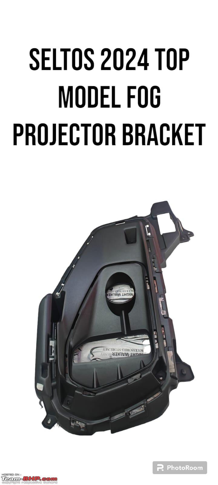

Does anyone know by how much I can upgrade the Seltos Lamps for GT Line facelift model?
My scenario-
I would be installing 2/3 inch projector fog lamps in a custom made bracket, which will also house the stock ice cube fog lamps.
I am confused if 2 projectors of 75 W with Laser each would be too much to handle for the battery? Price- 18000.
Other option I have is of 2 projectors of 42 W each. Price- 14000. But would this be insufficient?
Attaching pic of bracket. Also should I make the fog lamps to be synced with upper/dipper switch of main lamps, or should it be on low beam permanently, so as to avoid any issue with warranty.
My scenario-
These brackets fit only 2 inch projectors which you can get on Aes and GTR and DHC. The Aes q2m has the best beam distribution and reach. It also has laser for high beam.
It is 40w in low beam and 8w for laser and another 12w for the high beam shutter.
In the seltos I would recommend not going over 50w so you can connect the low beam and the laser but don't connect the High beam shutter.
That would give you best results without tapping the high beam. I would not recommend the high beam tap as that will definitely void warranty.
My scenario-
there are brackets to hold 1 or 2 projectors for seltos easily available in delhi ncr. You can just get the bracket and install projectors. Also generally these brands over report the wattage and actual power use is much lower. Still you can use a fog lamp relay for peace of mind.
Example:
Auto Lighting thread : Post all queries about automobile lighting here-screenshot_20240301_235741_instagram.jpg
