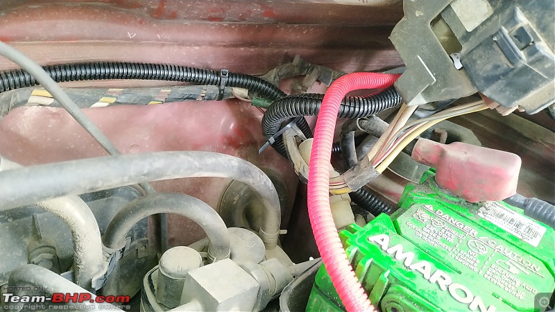

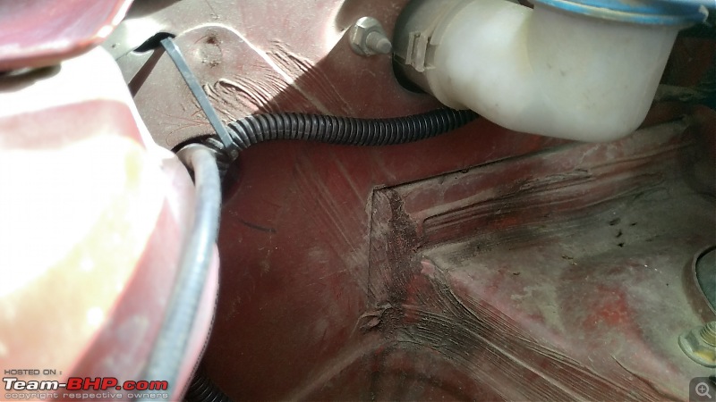

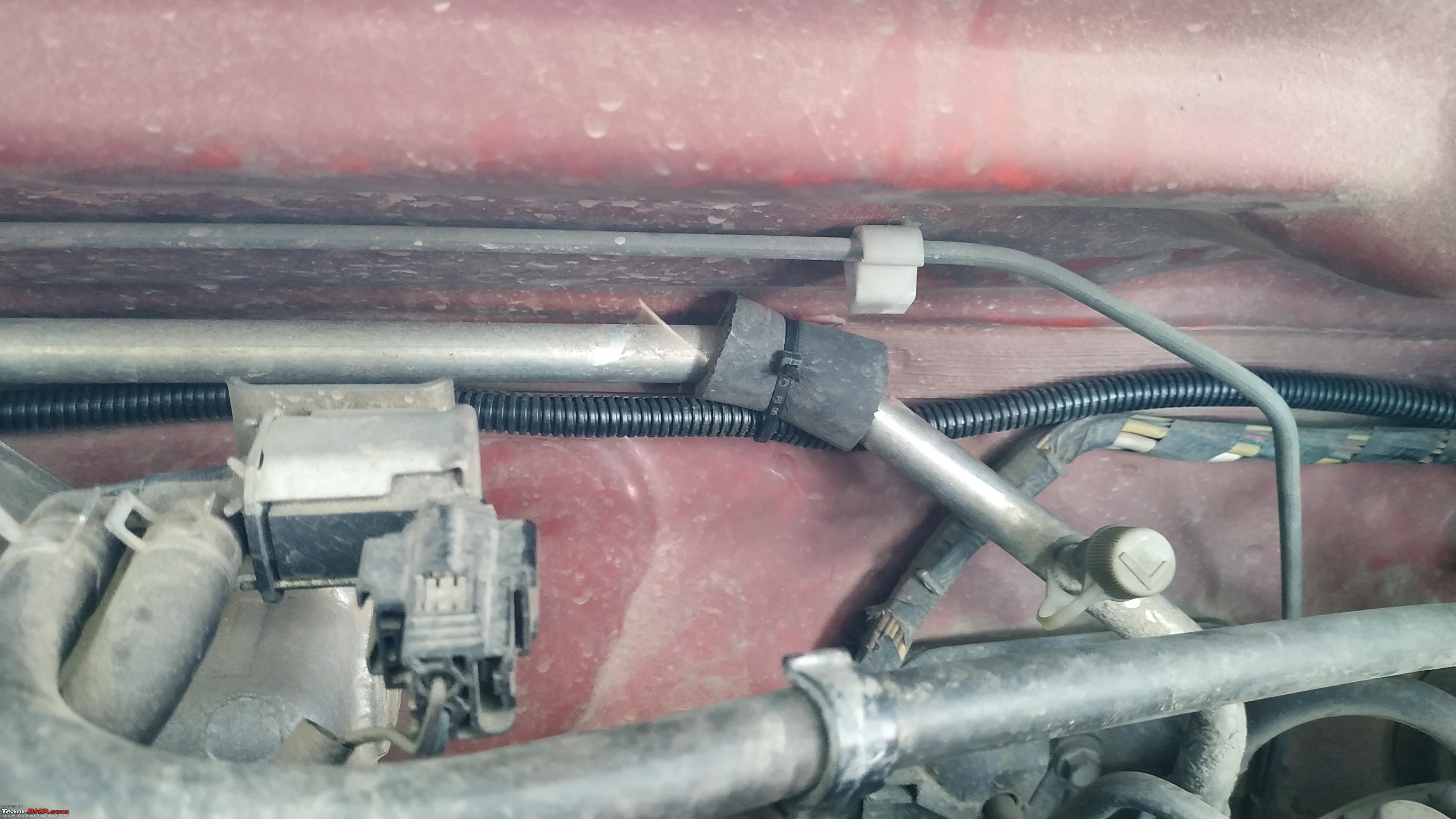

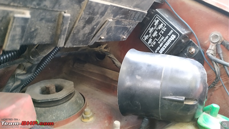

Hello All,
My headlight upgrade path for f10d wagon r:
1. Stock h4 55/60 felt inadequate for night drives, so installed h8 fogs (should be 35watts each) into provided empty fog light slot.
2. Even with stock h4 55/60 + h8 fogs, light throw is not strong.
3. As third measure, replaced stock h4 55/60 with philips extreme vision. Low light beam throw is good, but high beam throw is pathetic.
4. Fourth and hopeful final measure, this weekend did DIY to replace stock headlight wiring with thimpson heavy duty headlight 100/130 relay kit.
5. Currently running new wiring kit with philips extreme h4 55/60 setup to test for realibilty of harness.
Conclusion: Tough time, to mount the relay, since i don't want to drill new holes in the body.
Removing headlight connector and fixing ceramic headlight connector at co- drivers line is a nightmare.
Next steps: Fitting 90/100 philips bulbs after few days.. Probably i will go to garage due to mess at co- drivers area.
