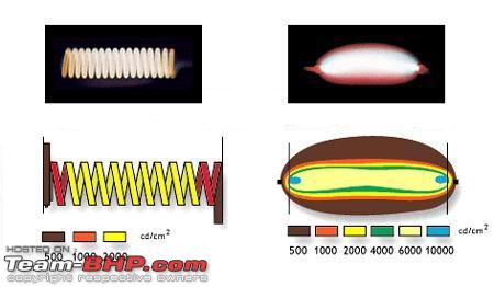

Well, there are mixed opinions about the HID conversion kits. Some says all the HID conversion kits creates glares and some say that branded one’s have less glare. Lets consider the facts first before arriving any conclusion.
Please go through this write up before you go for the HID conversion kits.
An "HID kit" consists of HID ballasts and bulbs for retrofitting into a halogen headlamp. Kits for replacement of standard round or rectangular sealed-beam headlamps usually include a poor-quality replaceable-bulb headlight lens-reflector unit that's not safe or legal even when equipped with the intended (usually H4) halogen bulb. Often, these products are advertised using the name of a reputable lighting company ("Real Philips kit! Real Osram kit! Real Hella kit!") to try to give the potential buyer the illusion of legitimacy. On rare occasion, some of the components in these kits did start out as legitimate HID headlight bulbs made by reputable companies, but they are modified (hacked) by the "HID kit" suppliers, and they aren't being put to their designed or intended use. Reputable companies like Philips, Osram, Hella, etc. never endorse this kind of hacked usage of their products. Nevertheless, it's easy to get "HID kits" from China bearing the (unauthorised, counterfeit) brands of major, reputable companies.
See this page (WebCite query result) for just a few examples of the many packaging options offered by just one Chinese maker of "HID kits".
Halogen headlamps and HID headlamps require very different optics to produce a safe and effective—not to mention legal—beam pattern. How come? Because of the very different characteristics of the two kinds of light source.
A halogen bulb has a cylindrical light source: the glowing filament. The space immediately surrounding the cylinder of light is completely dark, and so the sharpest contrast between bright and dark is along the edges of the cylinder of light. The ends of the filament cylinder fade from bright to dark. An HID bulb, on the other hand, has a crescent-shaped light source -- the arc. It's crescent-shaped because as it passes through the space between the two electrodes, its heat causes it to try to rise. The space immediately surrounding the crescent of light glows in layers...the closer to the crescent of light, the brighter the glow. The ends of the arc crescent are the brightest points, and immediately beyond these points is completely dark, so the sharpest contrast between bright and dark is at the ends of the crescent of light.
This diagram shows the very different characteristics of the filament vs. the arc:
Auto Lighting thread : Post all queries about automobile lighting here-filamentarc.jpg
When designing the optics (lens and/or reflector) for a lamp, the characteristics of the light source are the driving factor around which everything else must be engineered. If you go and change the light source, you've done the equivalent of putting on somebody else's eyeglasses: You can probably make them fit on your face OK, but you won't see properly.
Now, what about those "retrofit" jobs in which the beam cutoff still appears sharp? Don't be fooled; it's an error to judge a beam pattern solely by its cutoff. In many lamps, especially the projector types, the cutoff will remain the same regardless of what light source is behind it. Halogen bulb, HID capsule, cigarette lighter, firefly, hold it up to the sun—whatever. That's because of the way a projector lamp works. The cutoff is simply the projected image of a piece of metal running side-to-side behind the lens. Where the optics come in is in distributing the light under the cutoff. And, as with all other automotive lamps (and, in fact, all optical instruments), the optics are calculated based not just on where the light source is within the lamp (focal length) but also the specific photometric characteristics of the light source...which parts of it are brighter, which parts of it are darker, where the boundaries of the light source are, whether the boundaries are sharp or fuzzy, the shape of the light source, and so forth.
The only safe and legitimate HID retrofit is one that replaces the entire headlamp—that is lens, reflector, bulb...the whole system—with optics designed for HID usage. In the aftermarket, it is possible to get clever with the growing number of available products, such as Hella's modular projectors available in HID or halogen, and fabricate your own brackets and bezels.
Courtsey: Daniel Stern Lighting Consultancy and Supply
