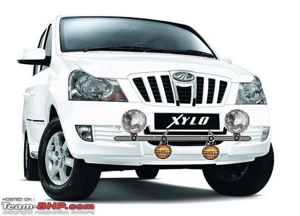

Hello Friends,
since long I have been wanting to put front auxiliary lights on my White Xylo. The ready-made bull guards didnt appeal me and the purpose wasnt any protection (I know, read on lots about the perceived protection and cons of chassis damage!). Actually I wanted a stand wherein lights could be fitted, and that being the sole objective. I even went to ask some if they could get it custom fabricated, but none could.
Recently, one search resulted me to a mfg for guards, carriers etc; having a workshop in Uttan, Bhayander. I managed to make him understand my idea and that would finally materialize in below shape.
Note: Images are randomly picked from googling (not my actual vehicle's pic) and modded in PaintBrush only for explanation of the design/concept.
Auto Lighting thread : Post all queries about automobile lighting here-xylo-guard-design.jpg
The base rod would be 35" long and 1.5" diameter, which would be clamped to chassis as usual. This would have welded slots for Neolites lights (pocket doesnt allow Hella!): the upper side ones for bigger clear color 10xx/11xx and 2 in bottom center for bit smaller yellows. Care would be taken not to hinder the number plate. All would be chrome finish and the cost quoted for fabrication alone is Rs.1500. I have given OK to this guy and would be ready to fix in a week's time, preferably on Sat since I have an off.
Experts, let know your valuable feedback on this setup.
The lights I would choose would be round and not rectangle, just to match the overall curvy shape of the vehicle. Suggestions most welcome also for Light models.
Sourcing of lights would be from Opera House, info collected from http://www.team-bhp.com/forum/4x4-te...ml#post2495741 . Last week I visited this shop, and casually asked for 1100, got quote of Rs.680/pair. Though they seem to be wholesalers, were ready to sell a pair.
Mods: hope this is the correct section for post.
thanks,
Pranav
