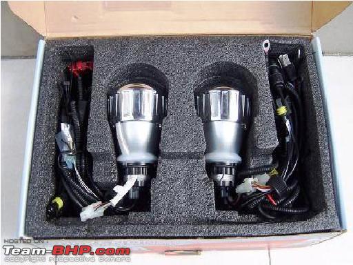

That's the first and foremost thing in choosing projectors. All projectors are not compatible, it depends on size of the HL assy, spread, height etc. But mostly people are concerned about the first parameter and compromise with the rest.
There's a very popular type of projectors are available in the market. Retrofit type. You need to pull out the glass by heating the gasket sealant, fix the projector from the front side to the reflector and tighten it with the screw to the reflector Done. Fix the glass by heating the sealant once again. Only the positioning will be remaining and that too in breeze. My projector is belong to this.
Here's some snaps
Auto Lighting thread : Post all queries about automobile lighting here-p1010081a.jpg
Auto Lighting thread : Post all queries about automobile lighting here-gchid-c21-.jpg
Another one with Packing
Auto Lighting thread : Post all queries about automobile lighting here-projector20kit20h4.jpg
