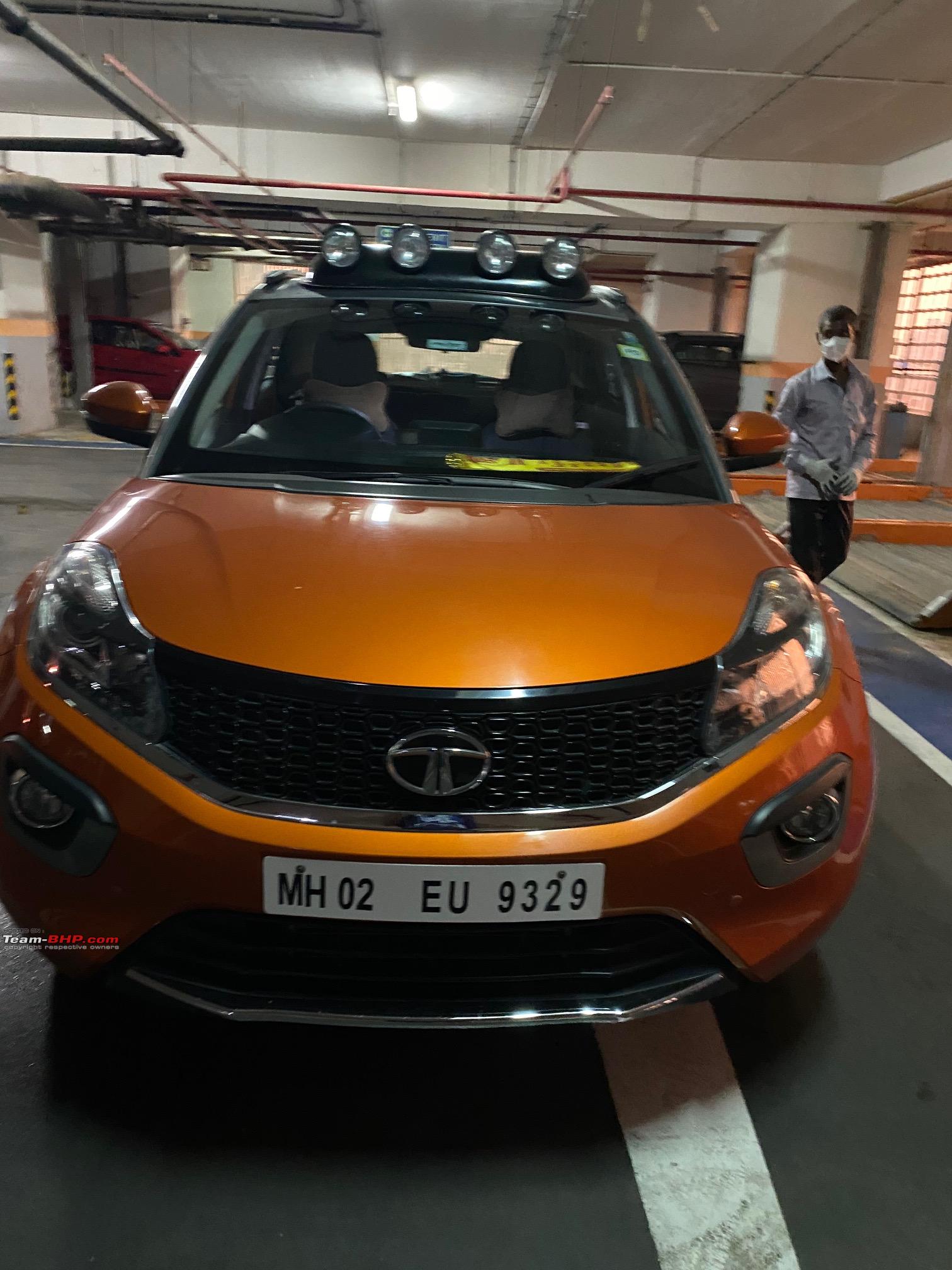

Hi does anyone know a good FNG or electrician in Mumbai (pref in the Andheri W) area to install a set off roof lights I just got for my Tata Nexon (which has woeful headlights (that also need replacement) but also for short getaways where highway lights are non-existent.
this light comes with 4 55W bulbs and a wiring (with relay and switch included).
I want a clean install without drilling or splicing wires.
I am a newbie on the electrical installs so any pointers would be helpful.
Also, this comes with 3M tape to be fixed which is not rebust..any suggestions if i should fix it with epoxy? though that may ruin the original paint below if i ever remove this.
Attached is a pic.. hope you guys like it. kind of inspired by the recent Offroad nexon render. I am still hunting for a front guard which could make a bit more macho, something for the headlights (a smoke wrap on the top perhaps), and I did find fender flares (still figuring out how to stick them without drilling, similar to the ones on the gypsies and Thar's).
Auto Lighting thread : Post all queries about automobile lighting here-image0.jpeg
Auto Lighting thread : Post all queries about automobile lighting here-2020tatanexonoffroadrender4.jpg
Auto Lighting thread : Post all queries about automobile lighting here-nexonoffroaderw.jpg
Avoid fixing such roof mounted stuff. You can't fix it safely without a drilled fitment or welded fitment.
And, cops will stop you and fine you.
For best lighting improvement; go for 3" bixenon fog projector with 55w HID kit for best lighting.
Hope this helps.
Cheers & Safe Driving
