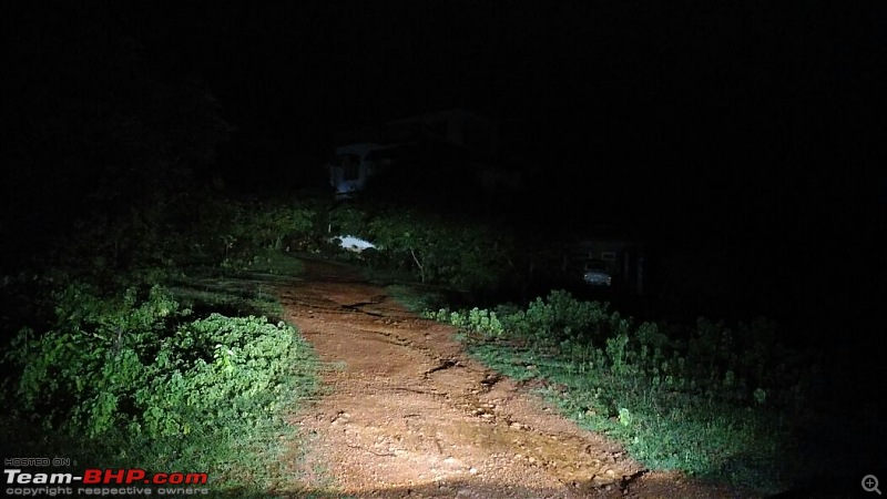

Originally Posted by Dr.Naren View Post
Output pics comparison : High Beam
I have been using Mini Super V2 projector setup in my Baleno from Xenon Planet. I have observed that the output looks brighter now (bulb break in period).
I am using AES projector kit in my SX4. I am not very happy about it for using for few months. I had issues like high/low beam getting stuck. Now I have observed bowing cut off. This is due to shield not getting back to it's place properly.
Baleno - Mini Super V2
Attachment 1531860
This mini super v2 output is impressive. Was it stock projector for baleno? If not how was the stock projector performance?
I have Baleno Zeta variant. It doesn't come with stock projector. I got Mini Super V2 retrofitted into my stock headlight assembly.
I have checked output of stock Baleno projector. It is just average and nowhere near to Mini Super.

Few more pics : Mini Super V2 from Xenon Planet
High beam output :
Auto Lighting thread : Post all queries about automobile lighting here-img20160730wa0002.jpg
Look at that thick colour band
Auto Lighting thread : Post all queries about automobile lighting here-img20160730wa0004.jpg
Auto Lighting thread : Post all queries about automobile lighting here-img20160730wa0003.jpg
Dr.Naren is online now   (2) Thanks
