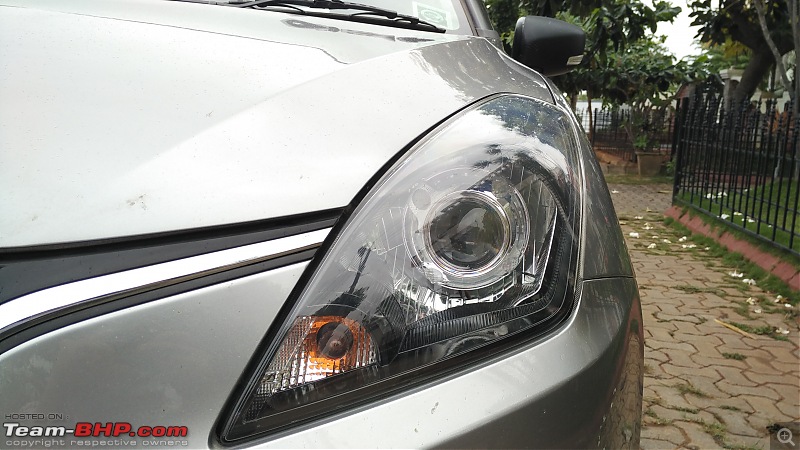

Projector retrofit for my Baleno : Xenon Planet
I have Baleno Zeta variant. After considering various options, finalised to get projector retrofit done from Xenon Planet. They have 5 types of projectors on sale.
1. Mini H1 : 11,000 Rs
It is the most basic projector and compatible only with 35W ballast. Almost all the Chinese/AES projectors available in our market are basically Mini H1 projectors.
2. Mini Super V2 : 14,500 Rs
This is the latest development from Xenon Planet and the best selling projector. It has very good high beam and easily beats most of the OEM projectors like Hella G5. It is compatible with 55W ballast.
3. Mini D2S : 16,500 Rs
Performance is almost similar as Mini Super V2. But, these projectors have advantage of installing OEM D2S bulbs.
4. Hella E55 : 19,500 Rs
It is an OEM projector. This projector has the best high beam but low beam width is average. Recommend for pure high beam fun on highways. Retrofit requires cutting of reflector.
5. FX-R V3 : 21,500 Rs
This is the biggest projector and costliest offering from XP. It has best low beam width and decent high beam. Retrofit requires cutting of reflector
Cost mentioned above is for the entire setup which includes projectors, bulbs, ballasts, shrouds and wiring. Installation charges cost 4,500 Rs
Xenon planet is based out in Chandigarh. But they have an installer in Bangalore with good experience. So I decided to get the retrofit done in Bangalore and finalised on Mini Super V2 setup (55W ballast, 4300K CN light hid bulb). Also, I opted for panamera shrouds which costs additional 2,000 Rs. Retrofit took around 6 hours. I got the headlights partially smoked (gloss black paint).
I am very impressed with installation and projector output. High beam is very powerful with good width and throw. I compared it with my friend who has Acura TL projector in his elite i20. Mini Super V2 had similar low beam but high beam was way better . Panamera shroud has very bright LED's and looks elegant.
I will post better pics soon. I am not able to capture the true output on roads, thanks to my phone camera.

Close up pics & High beam output :
Auto Lighting thread : Post all queries about automobile lighting here-img_20160704_124212.jpg
Auto Lighting thread : Post all queries about automobile lighting here-img_20160704_124204.jpg
Auto Lighting thread : Post all queries about automobile lighting here-img_20160704_194301.jpg

Originally Posted by procrj View Post
could you elaborate a little more on options considered and why xenon planet. few more questions
  • name of the installer
  • your feedback on the way the installation was carried out
  • was the reflector cut to fit the projector
Also do post more pics of the panamera shroud in the dark & does it come in red
Installation is done by Mr. Shyam from Bangalore. He has good experience in retrofits.
Installation was very professional. They used imported OEM type butyl sealant for resealing the headlights.
Reflector was not cut. Mini series projectors do not require cutting of reflectors.
Panamera shrouds are very bright and it's difficult to capture good pics. Panamera shroud from XP doesn't doesn't turn amber with indicator switch. Recently, TRS has come up with switchback panamera shrouds. I got panamera shroud with white LED. I think panamera shroud is available with different coloured LED bulbs. I have seen one with blue LED from XP.

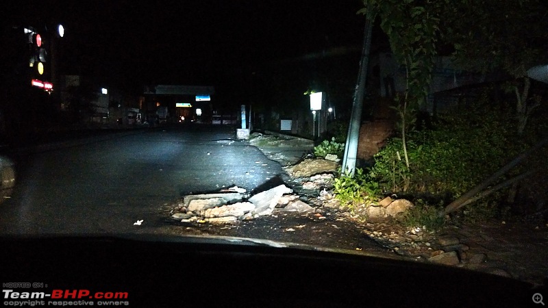

I took some shots from my mobile today, to share the performance of CREE XHP50 72W 12000LM H4 LED Headlights -
Only Fog Lamps On
Auto Lighting thread : Post all queries about automobile lighting here-img_20160706_001121_hdr.jpg
Low Beam + Fog
Auto Lighting thread : Post all queries about automobile lighting here-img_20160706_001045_hdr.jpg
High Beam + Fog
Auto Lighting thread : Post all queries about automobile lighting here-img_20160706_001059_hdr.jpg
Philips X-treme Ultinon H4 LED High Beam
Auto Lighting thread : Post all queries about automobile lighting here-img_20160313_195609_hdr.jpg
Please excuse me for pics as they taken from mobile. Actual throw is little more than its been captured in pics. Thank you.

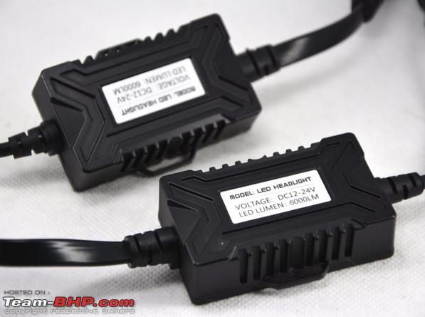

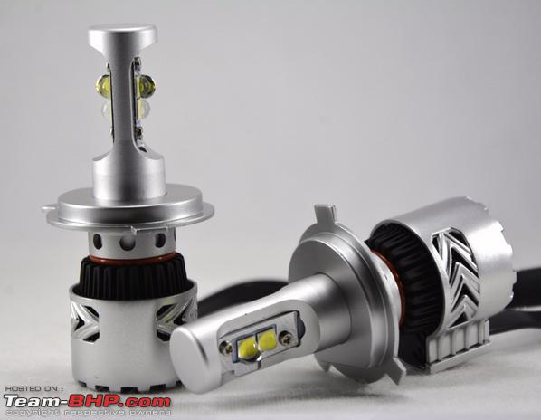

These are the actual Cree LEDs that I'm using and they have fan-less heat sink

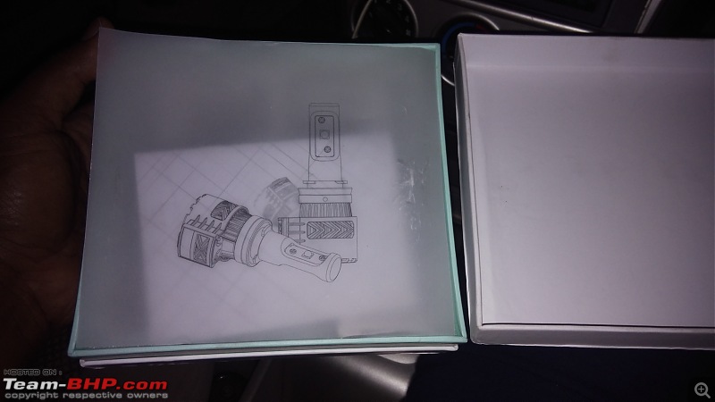

The packaging is also solid. Details about LEDs are on back of the pack (shown in pic):
Auto Lighting thread : Post all queries about automobile lighting here-img_20160709_010607.jpg
Auto Lighting thread : Post all queries about automobile lighting here-img_20160709_122707.jpg
Auto Lighting thread : Post all queries about automobile lighting here-img_20160709_122844.jpg
Auto Lighting thread : Post all queries about automobile lighting here-img_20160709_130153.jpg
Thanks.WHere did you buy this from?
arjithin is offline
Old 9th July 2016, 14:35   #9975
rahulgoel's Avatar
Join Date: Feb 2008
Location: Bareilly
Posts: 56
Thanked: 27 Times
I bought these from AliExpress. It took more than a month in delivery of these LEDs.
