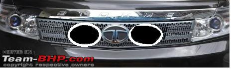

Hello @a4anurag,
I am badly contemplating on installing the Hella Auxillary lights onto my Storme.
But I am very particular how and where these should be installed. I would like the aux lights to be seated behind the front grill. Ofcoarse, I am ready to have the grill cut to light dimensions or remove the grill entirely.
Auto Lighting thread : Post all queries about automobile lighting here-5.jpg
So being a beginner on this front, could you please guide me to a trustable technician with fair amount of honesty on the equipment and wiring in Hyderabad.
Many thanks.
@Kams, try to get a smaller light, and mount them closer to the headlamps. The place you have chosen will block air flow to the radiator.
The alternate is to mount the lamps outside, in front of the grille.
