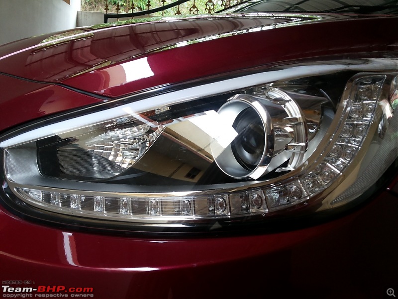

Few doubts regarding headlight upgrade.
I own a verna sx(o) which is having built in bi-function projector setup headlamps with halogen lights, 60w. I would like to change it to HID. Will it really improves the performance?
Once I went to a near by accessories shop and there the electrician guy, after checking the bulb told that it is 9006/hb4 buld. But in the car brochure it is given that the bulb is 9005.
What is the difference between 9006 and 9005. Is it possible to fix 9006 bulb on a 9005 holder. Will it cause any electrical issues?

@noblecr - no, they're not interchangeable. They look similar but the dimensions are different by a few millimeters. The holder diameter and filament location thus are not identical.
