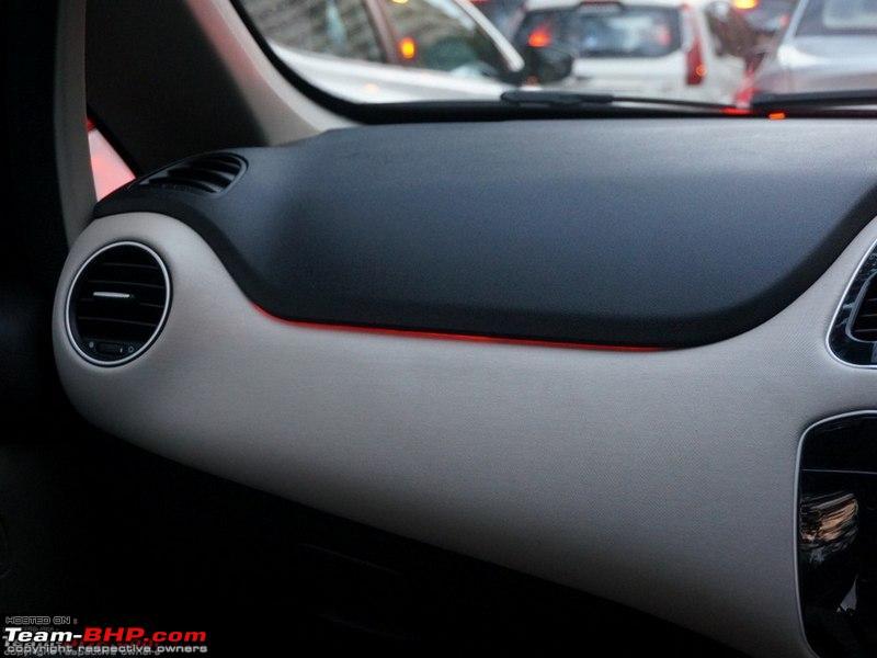

Hi Guys,
Needed your help with interior ambient lightning? Has anyone done it in their car? I'm looking at subtle lighting like the one shown in the image below:
Attachment 1360004
Was also researching further & found the ideal way I want it installed, but no help in the below thread:
http://www.team-bhp.com/forum/modifi...accord-v6.html
Rohan
Quoting myself, lol:, however the reason of doing that is that I did not get any reply on the same. I've seen a couple of people posting this query but no reply.
I've found a solution for the same & here is the final result:
Auto Lighting thread : Post all queries about automobile lighting here-0.-welcome.jpg
Details are there in my ownership review thread:
http://www.team-bhp.com/forum/test-d...ml#post3722905
Rohan Sachar.

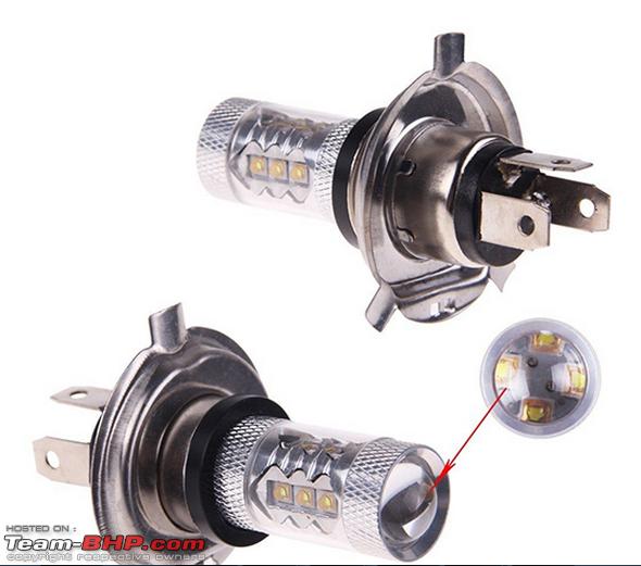

Guys, Any info about using LED bulbs in headlights? I am planning to buy these from AliExpress:
But before I take the plunge, thought I will check with fellow BHPians first - any first hand experience with them?
--Anoop
Attachment 1378328
--Anoop
Anoop, don't expect longevity from these cheap LEDs sold on Ali. They will light up brightly and would continue to do so for a month or so and would give up gradually. Reliability is poor in general.
Perhaps the outer shell looks like a heatsink to me but whatever heat is dissipated goes inside the sealed headlight itself with no access to fresh air available, to take away the heat. Unless you are buying these for experimenting, don't bother.
Thank you for the points.
The headlight of my Duke is pathetic I am on the look out for a solution. Have tried Osram NB+ earlier (In my car and In my Unicorn) but this time, I want something better which can light up the roads .
I found these while I was searching for CREE Aux lights and thought these as a better option since I do not have to fix aux lights. I could not find any branded LED light bulbs like this, so may be I will stick with CREE Aux lights.
--Anoop
Guys, Any info about using LED bulbs in headlights? I am planning to buy these from AliExpress...
Anoop, I'd suggest not to buy them if your intention is to obtain better light output and not an experiment.
1. Your Punto's & Duke's headlights' reflectors are designed to scatter light from incandescent bulbs' filaments, which radiate light in all directions, while LEDs are directional, their light output is concentrated in a limited angle. Having multiple strings won't effectively mimic the filament
2. High chance that these LEDs would conk off. Yet to come across anybody who's used them extensively and has a positive feedback. The make of the LEDs is a suspect
3. With LEDs, heat dissipation is the biggest concern that cannot ever be overlooked. There is no way all the heat generated by these many LEDs can be taken out of the HL dome, looking at the structure. Unless of course they have some special, hi-tech, thermally superconducting thingamajig there
Will send you an interesting link through WhatsApp :)
Ok, you have totally convinced to drop the idea. Will wait for the link :)
--Anoop
