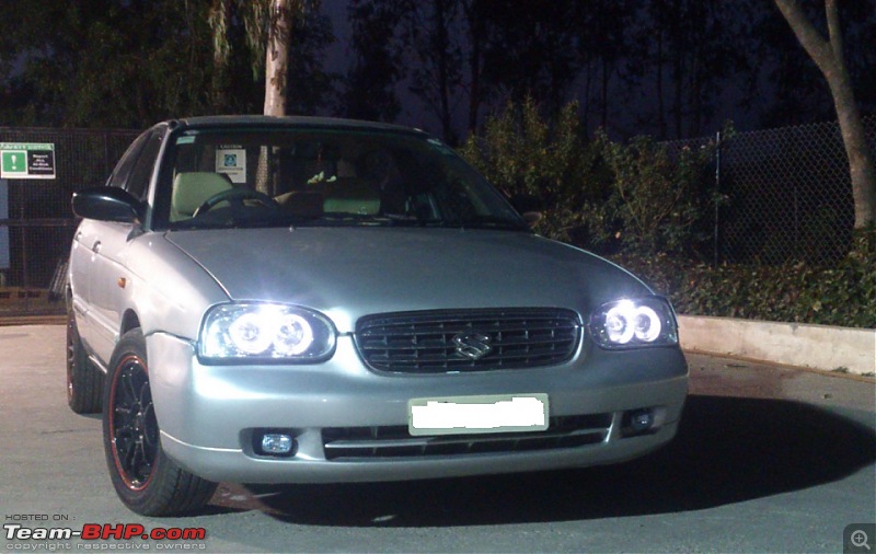

Own a Baleno. I guess most of the owners know the Achilles heel in this very competent sedan has to be the lighting provided.
I do a lot of highway runs, hence needed something robust and reliable.
Did a lot of research, upgrading the 55W halogens to 130/100W with a separate harness was something I quite thought about.
But bad experiences from friends who had done this in the past kept me away.
Was always a fan of projector headlamps and researched thoroughly on the subject.
Finally decided to take the plunge. Got a set of Spyder Headlamps and also a set of Hella fog lamps back from a trip to the US.
The mounting on the existing points was always going to be tricky. Tried a lot of body shops to get a feel of their expertise.
At last decided on a reputed body shop who had their own painting booth to do the job. It took almost a week to complete the modifications and also more than the headlamps themselves to finish the work.
But I can happily say that the end result is way better than before.
Also, the angel eyes add their fair bit of drama.
Had to get the focus adjusted, but apart from that, no complaints!
Future upgrades planned include a switch to 4K HIDS.
Enough talking for now, let the pics do the talking.

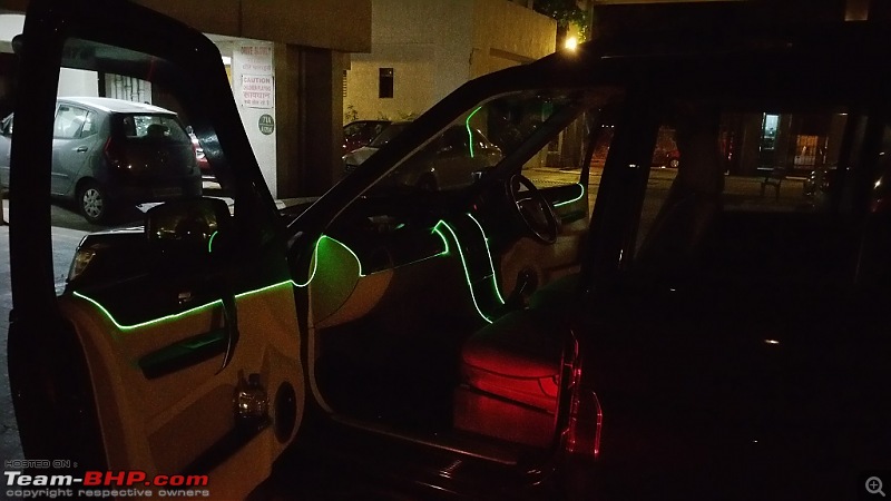

I've found a solution for the same & here is the final result:
Auto Lighting thread : Post all queries about automobile lighting here-0.-welcome.jpg
Details are there in my ownership review thread:
http://www.team-bhp.com/forum/test-d...ml#post3722905
Rohan Sachar.
