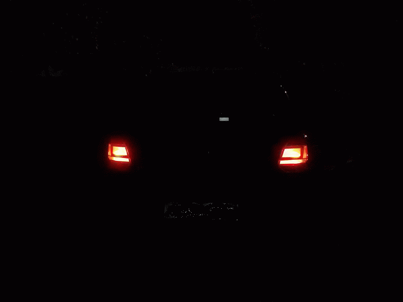

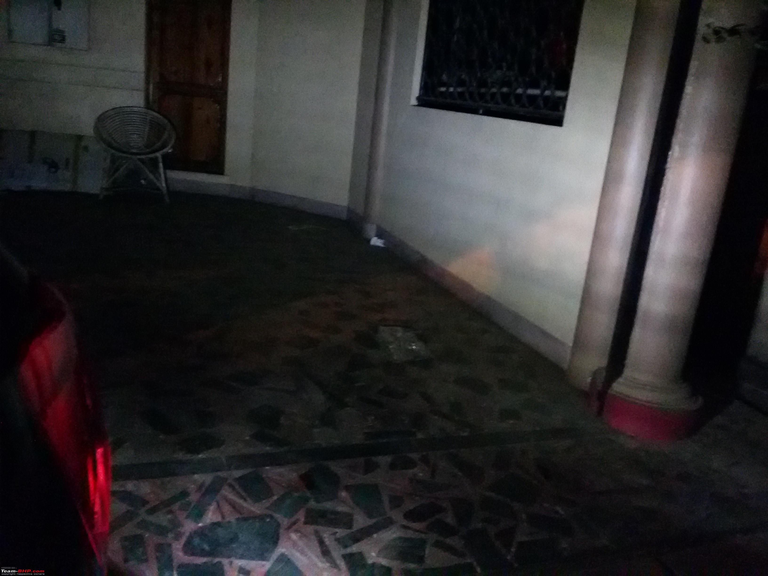

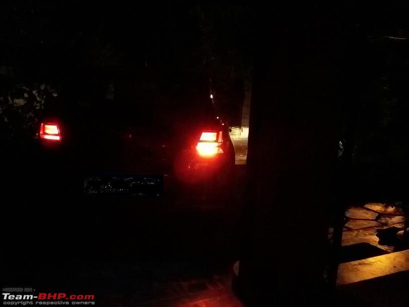

Some time back i bought some Philips LEDs to replace the signal lights of my Swift. You can find the details in the link below:
http://www.team-bhp.com/forum/modifi...ml#post3452508
The Swift was sold and i bought a new Polo GT TDI recently, and i had with me those LEDs that I had removed from the Swift before i sold it. So today decided to put them to use in the Polo tail lamp cluster. So here it is
The taillamp opened to install the bulb. Only one side photo taken :(

  1. Philips W5W 4000K bulb which was in Swift's front parking light used for tail light.
  2. Philips PY21W Amber bulb used as indicators (without load resistors, in the Swift i used load resistors).
  3. Philips P21W White LED which used for reversing lamp. It was doing the same duty in the Swift and Swift had two reversing lights.
  4. On the RHS taillamp assembly i have used the other Philips P21W White LED from the Swift reverse light for fog lights. The fog light portion has a red bubble over the bulb so the white lamp is working better than i had expected it to and i don't have to buy P21W Red for the rear fog light.
Results:
Tail lamp
Auto Lighting thread : Post all queries about automobile lighting here-20150403_193356.jpg
Indicators
Auto Lighting thread : Post all queries about automobile lighting here-20150403_193447_013.jpg
Auto Lighting thread : Post all queries about automobile lighting here-poloindicatorflashing.gif
Open the ^ gif in another tab to see the animation.
Reverse light - Now its USEFUL! Stock Polo reverse lights are weak.
Auto Lighting thread : Post all queries about automobile lighting here-20150403_193710.jpg
Auto Lighting thread : Post all queries about automobile lighting here-20150403_193657.jpg
Rear Fog light - Not bad for a white LED
Auto Lighting thread : Post all queries about automobile lighting here-20150403_193537.jpg
Auto Lighting thread : Post all queries about automobile lighting here-20150403_193613.jpg
I did the number plate light also, used an ebay LED which is think is 6000K. Not visible in the pics because i blanked out the plates rather shabbily.
