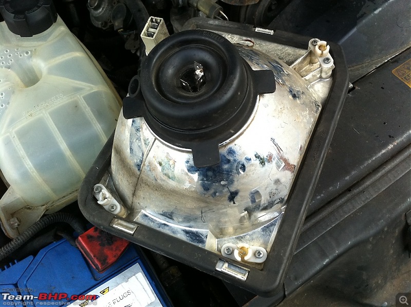

I had installed 100/90 bulbs in my i10. While adding the relay and bulbs, the installer had cut the rear cap like something for wiring. Now this monsoons I am facing the issue of headlights fogging from inside and water droplets collecting.
The service center guy told me that since you have cut that plastic cap, water seeps in causing the fog.
Is there any solution like if I tape the cutout part. Many i10 users in this forum have upgraded their bulbs. Anybody else facing this problem?

You can usually find a rubber type of bush which is used to cover the end portion of the headlight assembly. I had them in my projectors which prevent water from seeping in. Something like this.

I wouldnt recommend HID's on OE headlights as it will scatter the light and blind oncoming vehicles. Yes, since you are planning to retro fit projectors onto your headlights, you will need to give the existing headlights for him to work on. "Is it safe" depends on his quality of work. I would suggest you to check some of his previous works, talk to his previous customers etc. That's the best you could do at this point of time else you will need to take the plunge and take that risk. But most of these guys do an excellent job as only experienced guys do these kind of installations.

How big is the hole?
When i upgraded the i10's lamp as DIY i made sure that i made the hole just big enough to pass the wires through. Had to take out the three pin bulb connector and re assemble this to pass the wires through. The hole was then sealed with silicone sealant.
If the hole is too big you can use duct tape to seal it off, apply it over the hole as a X and use rtv silicone sealant to seal the gap the wires come through.

What Shankar said is the way; try to seal it with a proper sealant.
What you can do is to make the mechanic arrange for a pair of those plastic caps from the accident cars that arrive at the dealership. You can replace the existing ones with those. The hole has to be made and sealed properly in the new one, though.

Thanks guys. Actually I should have realized at that time only about the hole. It is quite big cutout. Will visit a garage soon. Its only RHS headlight that is facing the issue. LHS is somehow safe.
Thanks Naveen for that idea.
