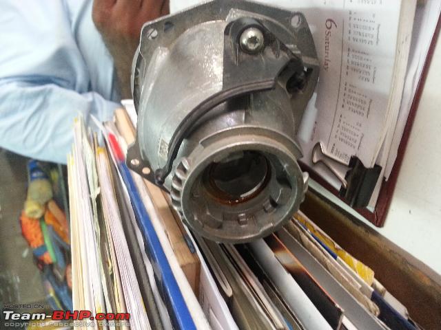

Can someone help me and identify the bulb type that I need for this projector and which car out came out from. I bought it used and since it has a electro mechanical hi lo setup I would like to use it for my Jeep. Any help would be greatly appreciated.
