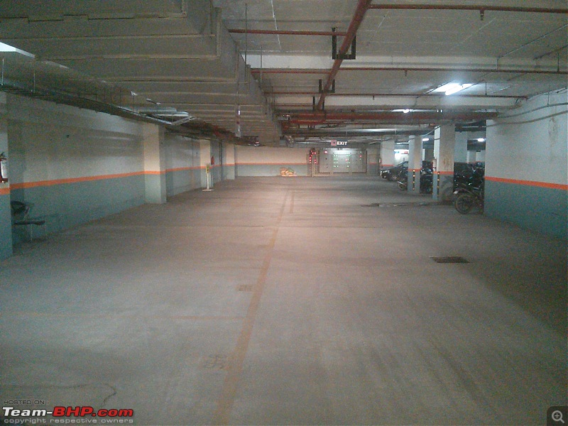

My colleague who owns a 2015 Ertiga asked about suggestions on better lighting and as usual I asked him to start with Philips Extreme vision.
But later it struck me that I can do a side by side compare of Extreme vision vs stock bulbs since My Ertiga is fitted with Extreme vision. So we went to our office basement where we can do a simple test.
The results are given below. I couldn't find any significant difference between the stock and Extreme vision. ( I am not aware if 2015 Ertiga comes with Extreme vision as OEM or not. I will check that tomorrow and update the thread with stock bulb information)
Left side of the yellow line is stock bulbs and right side is extreme vision. Photos are taken with a Nexus 4 in auto mode standing between the cars. Description below is based on my observation than the photos.
1. Low beam with levelling at the lowest position
I could see some improvement in low beam for extreme vision
Auto Lighting thread : Post all queries about automobile lighting here-complow.jpg

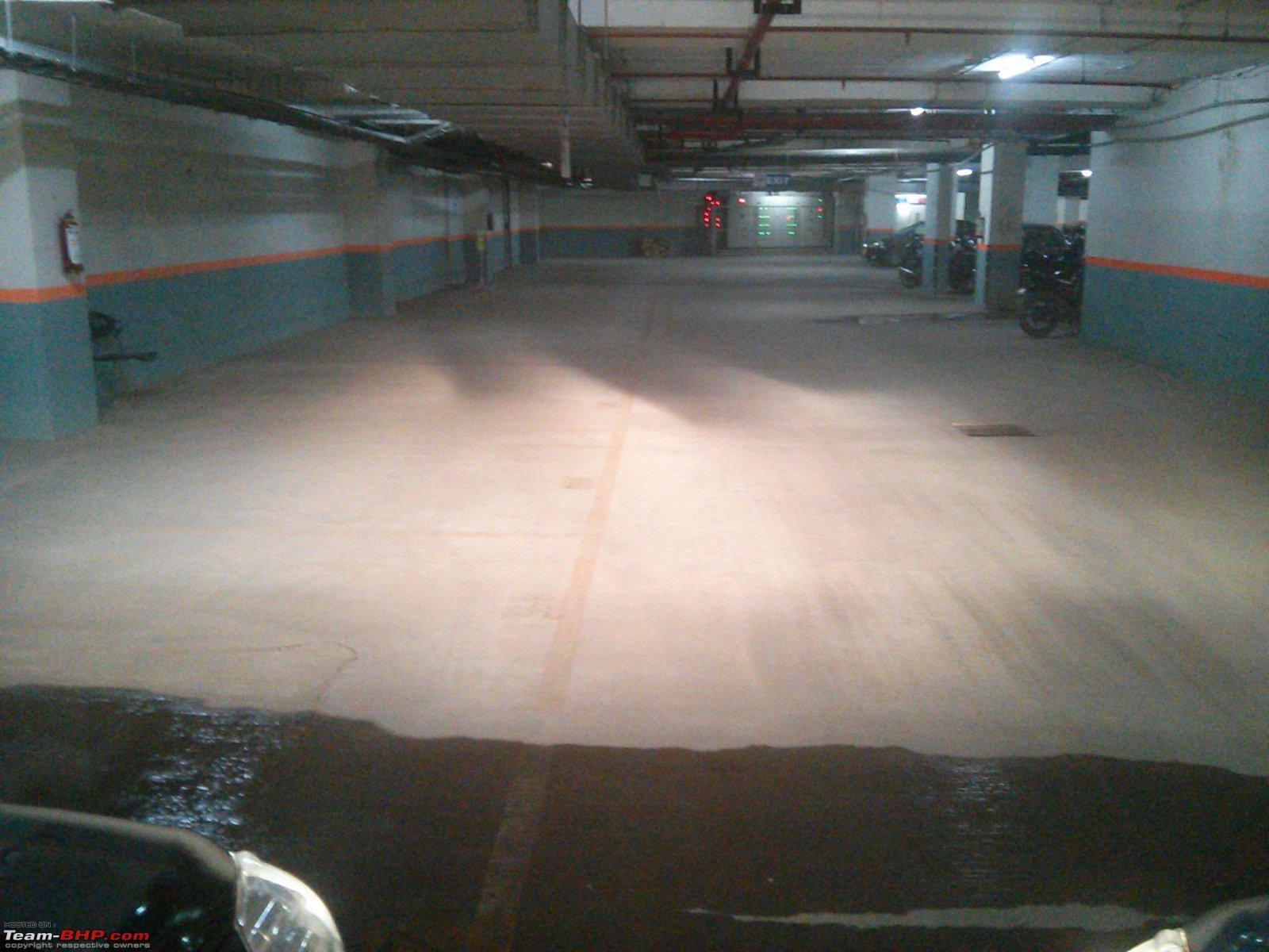

2. High beam with levelling at the lowest position
Improvement barely noticeable
Auto Lighting thread : Post all queries about automobile lighting here-comphighlow.jpg
3. 2. High beam with levelling at the highest position
Improvement barely noticeable. Difficult to judge the difference as both the car lights started merging.
Auto Lighting thread : Post all queries about automobile lighting here-comphighhigh.jpg
So much hype for these ExtremeVision. it feels like you have some difference when seen in isolation but otherwise the difference is super negligible. I too have resorted to HIDs in my XUV after doing trials with stock Osram and Philips ExtremeVisions!

I have a Swift and using Philips Extreme Vision+. Stock bulbs were Osram Bilux, but they were pretty useless, specially in my city where there are a lot of two wheelers which can change direction anywhere, anytime.
The biggest improvement of Philips Extreme Vision+ will be in a stronger low beam. What this eliminates is the need to use high beam. If properly focused, low beam is pretty strong for urban and outskirts driving. On highways, again they are not strong enough.
Problem with these bulbs is high beam focusing, not intensity.
May be due to different length of bulbs and hence filament placement, if I try to have a well focused high beam, low beam focusing and length of throw suffers. The focus of stock bulbs was near prefect in both high and low beams. But with Philips Extreme Vision+, either I can achieve good high beam focus or low beam focus. The setting I have done is for good focus in low beam. High beam focus is not as good as I would have liked, but most of the times low beam is going to be in operation. Probably that is the reason why you feel that high beam improvement is not much.
May be next time I will try Osram Night Breaker+. Best way to improve the light performance is to have a relay and have 90/100W setup. The strong low beam then is good enough for most of the times. There are many members who have this set up installed, and I am planning to get back to it too ( I earlier had that set up in my Swift too for a brief amount of time ).
Not discounting the fact that reflector design also plays a role in illumination, your experiment goes on to prove that there really is no replacement for Wattage (the auto-lighting equivalent of No replacement for displacement adage) in incandescent bulbs.
Not just you but many including myself didn't find any difference with the Xtreme Vision over stock. The marginal improvement is only a placebo effect and nothing else.
A reason why I didn't even try them in the Ertiga and straightaway replaced with 100/90 H4 Philips Rally with Wiring Kit and Relay. Something that I have in WagonR for over 150,000 kms and in Ertiga for over 100,000 kms.
For the regular usage of mine in both the cars, the WagonR's reflectors are still stock and haven't faded like we typically see. I mostly manage only with low beams and high beams come to rescue based on needs.
