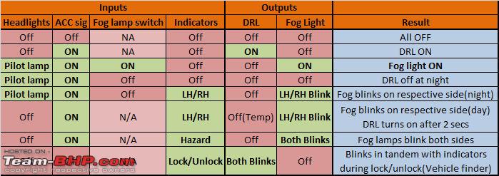

I am still in the process of understanding the logic followed by the controller. Its quite intuitive. As of now, this is how it works
Auto Lighting thread : Post all queries about automobile lighting here-logic.jpg
Here is a video:
https://www.youtube.com/watch?v=QRbP...ature=youtu.be
