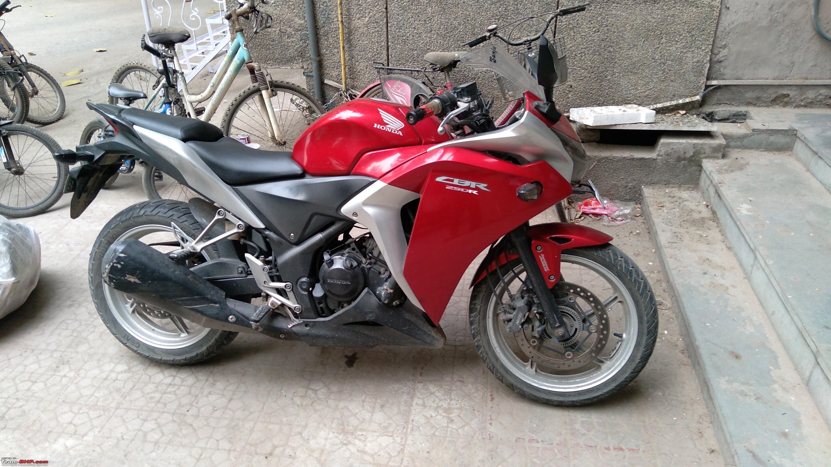

Here she is, 2012 Abs done 32k. And it’s the colour I wanted, finally have full filled my childhood dream. Needs to be cleaned and serviced but runs like a charm regardless.
Attachment 2303793
Congrats mate on your purchase! Believe me, your next upgrade will definitely be a Japanese Multi-Cylinder machine, coz you'll be spoiled with all that refinement.
As mentioned before, go through all these threads and be informed about a few points.
Once again, congrats. And ride safe.
Congrats. You got the color that you were looking for.
Few things.
Get the exhaust shield replaced or repainted to silver. New one would cost barely Rs.700. that's the only thing spoiling the look.
From the pic, it seems there is a leak (unless it was present on the ground from before you parked the bike there). So get it checked.
Ensure the lockset is working fine. Use wd40 or few drops of gear oil into the key hole every few months. The lockset of 2011-13 model is insanely expensive and not easy to find as well.
Good Luck...
