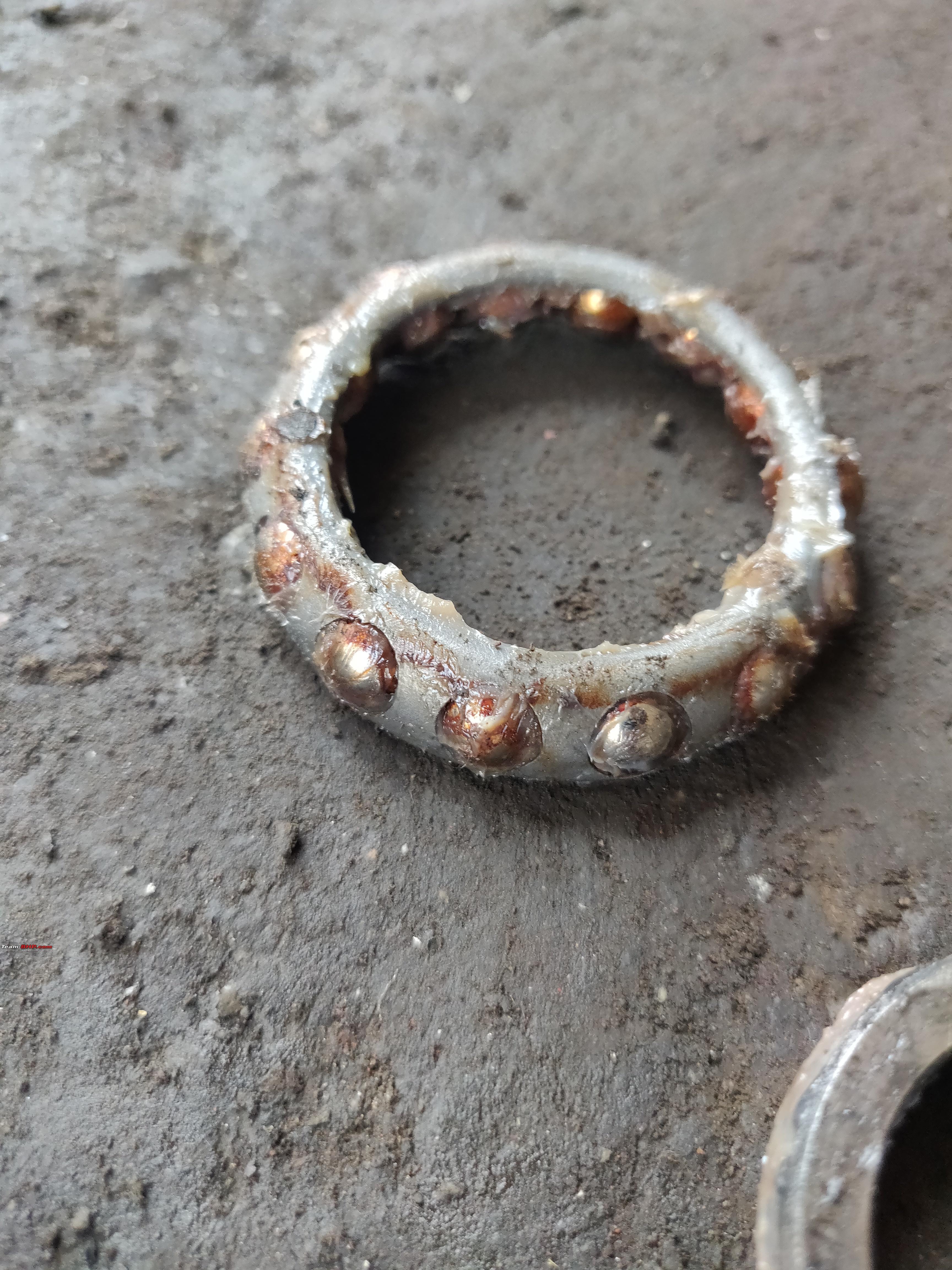

Re: Honda CBR 250R : Answers to some commonly asked questions
Hi everyone,
I am facing a handle wobbling issue. At highway speeds of around 50-60 kmph, if I leave my hands (on open roads and with gears) the handle wobbles quite considerably, not violently, but not too mildly to ignore.
So both the tyres have been changed to Michelin Pilot Street 2 at the front, the wobble was present. The handle bar had started vibrating too, and on doing Mumbai Pune wearing gloves, my hands go numb by the end of the trip. In city without gloves too there is a tingling sensation even for 5-10 KMs ride abouts.
So today, I changed both the conesets (₹1200 for both sets + ₹400 labour) as the mechanic said it has some scoring marks and I thought cone set is another dominant reason for wobbling and vibrations at the handle.
Even after changing, no luck, everything is as it is. Vibrations have mellowed down quite a bit I think, need to observe for another week to confirm.
But the wobbling is present, and even jerks are felt during braking and also when riding over rumble strips for example.
Attaching few photos below.
Please suggest the next course of action.
Honda CBR 250R : Answers to some commonly asked questions-img_20220410_131526.jpg
Honda CBR 250R : Answers to some commonly asked questions-img_20220410_131534.jpg
Honda CBR 250R : Answers to some commonly asked questions-img_20220410_132054.jpg

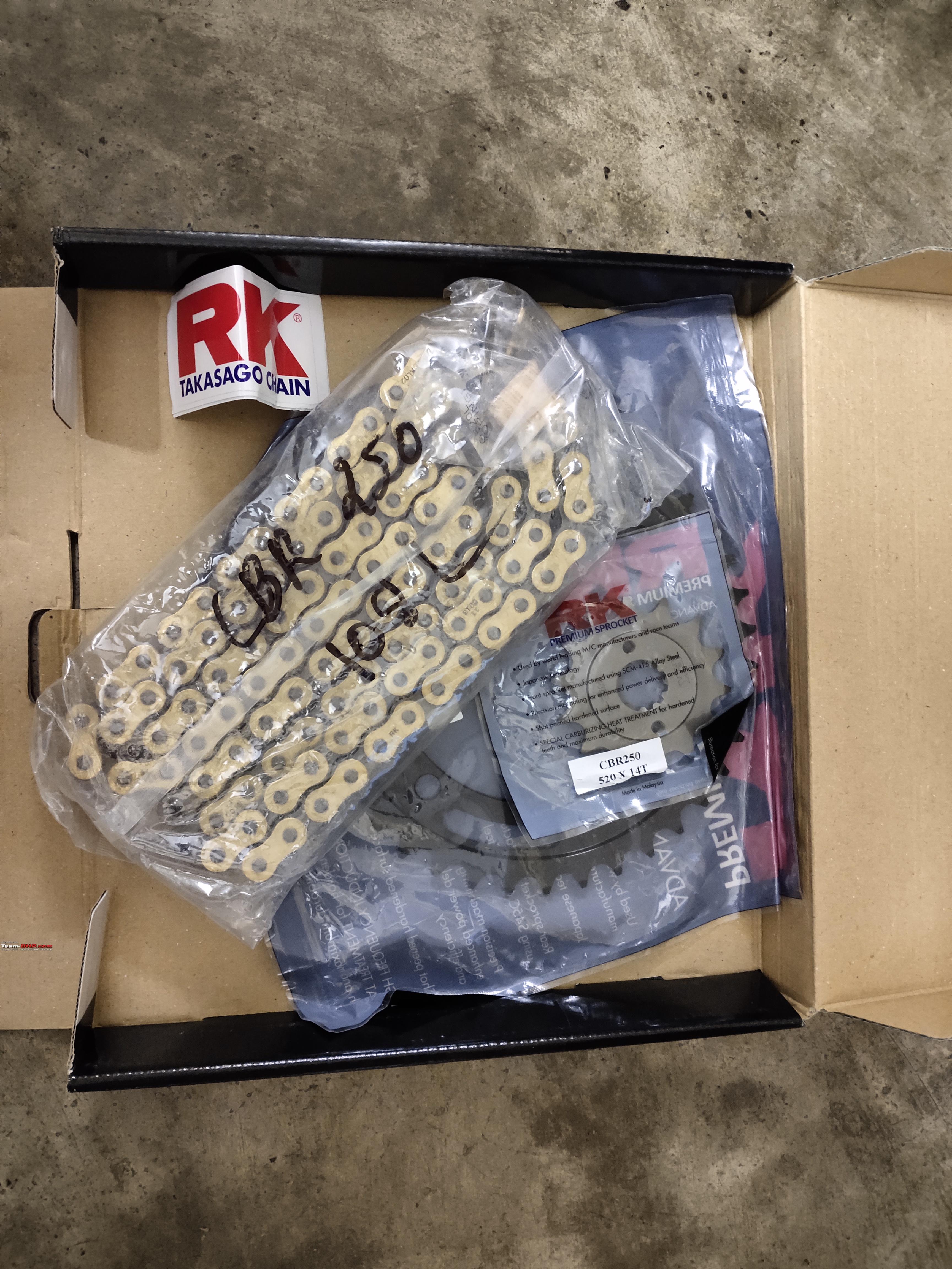

Originally Posted by ManasN95 View Post
Hi Siddhant, can you please share the costs involved and where did you source it from? If possible a few photos too please. Thanks.
Got the chain sprocket kit from lrlmotors.com where total cost was Rs 2900 (incl shipping) + Rs 450 (labour charge for installation). 7aftermarket.com is also selling this.
Honda CBR 250R : Answers to some commonly asked questions-img_20220121_180019.jpg
Honda CBR 250R : Answers to some commonly asked questions-img_20220121_180042.jpg
According to some online websites, the X-ring based chains last twice as long as the O-ring chains and have better performance. Considering that the RK Takasago chain kit was retailing at just Rs 2800, it would eventually prove cheaper than the regular Rolon chain and I wouldn't have to worry for the next 30000 kms at least.
Honda CBR 250R : Answers to some commonly asked questions-img_20220121_180147.jpg
Greetings to you,
1. The cone set for top ball race, size of balls small
cone set for bottom ball race, size of balls large
Grease grade for cone set should be "thready" should not turn dry or melt.
The visible rust is signs of malfunction and pressure washing the front stem.
2. Under the front mudguard is a U shape Brace.
This is for equalizing top to down or down to top suspension damping.
Twisting of fork legs.
3. Inspect the inner working of the front suspension.
If the hydraulic oil is oxidised(old), dark change the oil, equal qty refill prime and close the top nut. No need to open the down allen key nut.
Measure both fork springs length, on flat table.
Get this done by some professional.
The above handle bar shake could escalate to tank slapping.
Even at safe speeds this sudden loss of control could lead to ...
I don't have to spell this out.
Best regards to all.

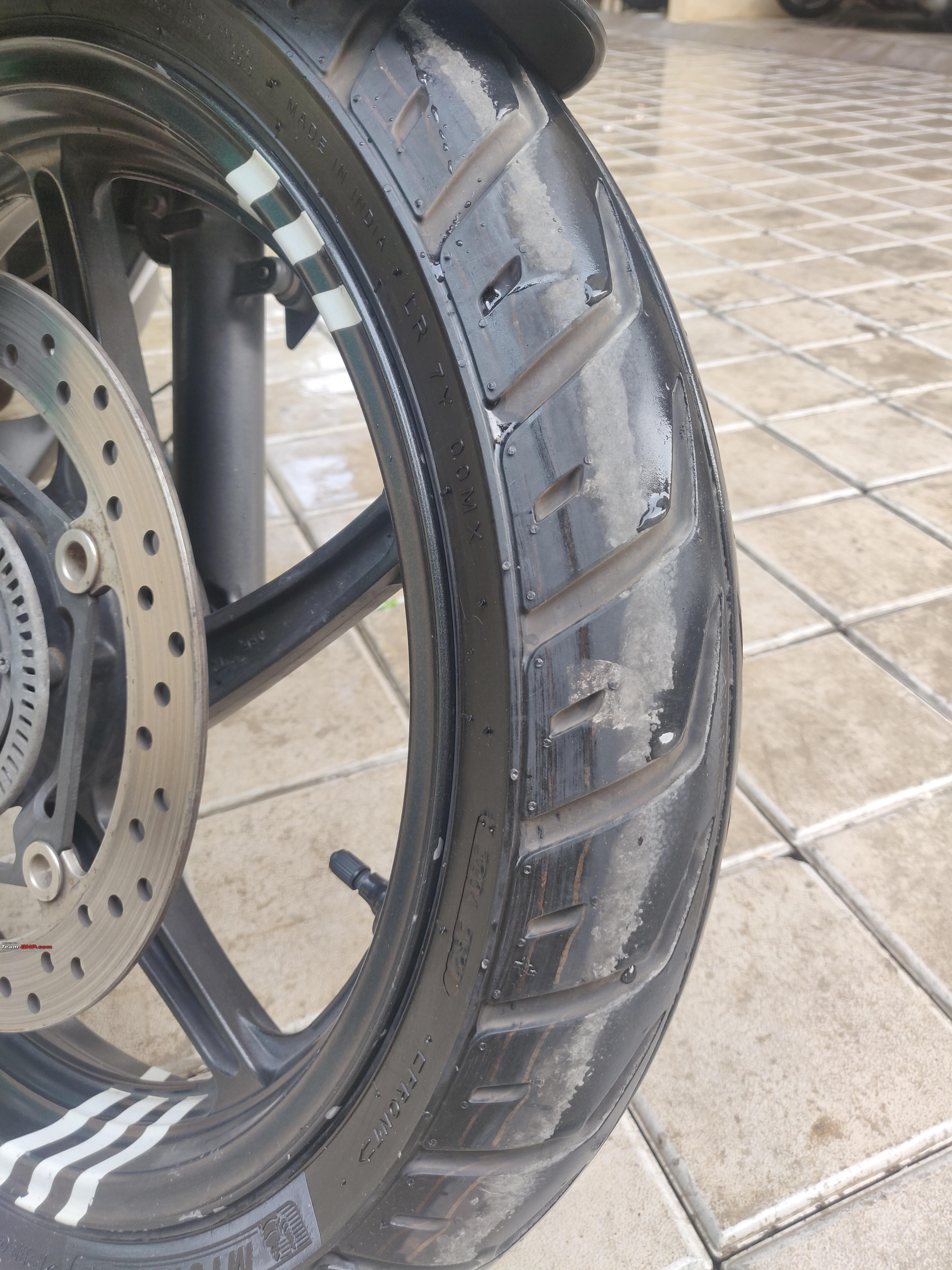

Pls show us some closeup & long shots of both front & rear tires. Also share the picture of manufacturing date from the tire pls. Tks

Thanked: 468 Times
Originally Posted by joednazareth View Post
Greetings to you,
Tks
Hi Joe,
I have changed both the bearing sets, and the fork oil was changed during last service too, to Motul Heavy.
What else can I check?
Aargee Sir, attaching the photos below. Please have a look.
The tires are manufactured in 36th and 37th month of 2021 respectively.
Honda CBR 250R : Answers to some commonly asked questions-img_20220411_074506.jpg
Honda CBR 250R : Answers to some commonly asked questions-img_20220411_074501.jpg
Honda CBR 250R : Answers to some commonly asked questions-img_20220411_074528.jpg
Honda CBR 250R : Answers to some commonly asked questions-img_20220411_074536.jpg
Honda CBR 250R : Answers to some commonly asked questions-img_20220411_074626.jpg
Honda CBR 250R : Answers to some commonly asked questions-img_20220411_074657.jpg
Honda CBR 250R : Answers to some commonly asked questions-img_20220411_074825.jpg
Honda CBR 250R : Answers to some commonly asked questions-img_20220411_074814.jpg
ManasN95 is offline   (2) Thanks
Hi! Manas,
Greetings to you.
1. Install heavy duty - Black 39mm Fork Brace. You can install this without dismantling anything on the front forks.
2. Check all fasteners on top of the triple tree and under the triple tree (handle bar fasteners) for tightness , check yoke nut / check nut for play which is normal after the service of front steering bearings/ball race.
3. Front tyre center line with rear tyre alignment check.
4. When did this front handle bar wobble get noticed. What did you add, remove, adjust or give your bike for service before this issue.
joednazareth is offline   (1) Thanks

Old 11th April 2022, 15:51   #704
aargee's Avatar
Location: TSTN
Posts: 6,355
Thanked: 10,072 Times
I'll take it as 36th & 37th week pls.
Tires looks good, I've the same set of front tires now & I'm positive they're good & don't expect defective manufacturing.
Try to deflate the front tire completely & inflate once again & see if it addresses the wobble. If it isn't troublesome experiment, try switching back to OE fork oils & see if there're any differences pls.
Next things I can think off are for bent alloy wheels, worn out wheel bearings. If you were in Chennai, I can assure to fix this by troubleshooting the issue because Didar does a phenomenal job in such things.
For how long is this wobbling going on? If its like for over 5K Km, then if you're able to dismantle & show us the brake pads, that might leave us some clues.
aargee is offline   (1) Thanks
Old 11th April 2022, 18:17   #705
ManasN95's Avatar
Join Date: May 2020
Location: Thane
Posts: 209
Thanked: 468 Times
Yeah, weeks
This wobbling has been going on since 3-4000 KMs. During that, I have sold her, she got serviced too, in which the cone set was adjusted as per the invoice, and I happened to purchase her again. Story for some other day.
Oh and yes, during her exile from me, she dropped from standstill to the RHS. But I'm pretty sure the wobbling issue has been going on even before I sold her.
ManasN95 is offline   (1) Thanks
