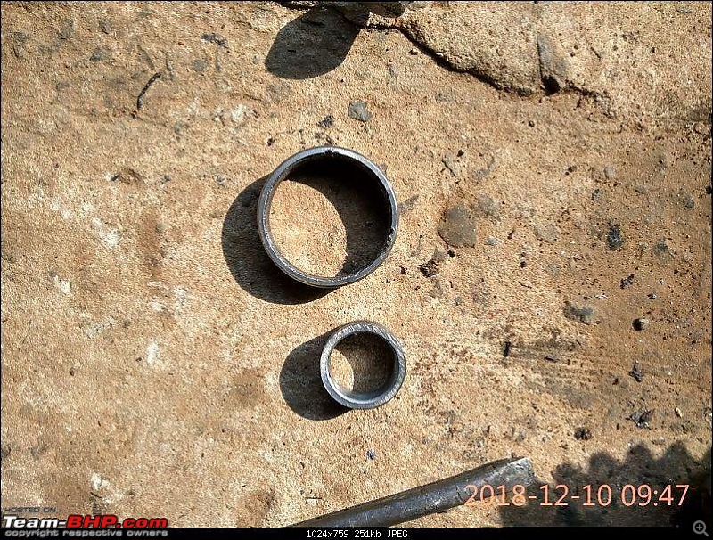

So my bike went in for service at IndiMotard before I tookoff to Bhutan on 8/12. I had informed them about my plans and asked them to go ahead and replace any part if it can play spoilsport on my ride. The bike was with them for 4 days before it was delivered.
Third day on my ride, 80 kms from Bhubaneshwar, I hear the chain slapping against the plastic guard. Immediately I ask a team member to check and he confirms the chain slapping. As the breakfast break was around half an hour ahead, I resume journey. A couple of kms and the noise gets worse. I ask another rider in front of me to check and he reports my sprocket is wobbling. Immediately we stop and I open the rear wheel to find the below.
Bangalore: KTM's service quality on a steady decline-img_20181210_094727_hdr.jpg
The sprocket bearing has missing balls and the cage holding it and only races were available. This was replaced before I got the bike from service and hardly lasted 1500 kms. There was a FNG where the mechanic replaced the bearing with a local make and until now it has run for 5k kms without any issue.
Second incident took place during the return, 50 kms to Sagar in MP. I brake for an obstacle on road let go and press again and I hear grinding noises from the front disk. On closer inspection, found brake pads have flown off the caliper. I rode around 300 kms without front brake and the KTM Chindwara did a patch up job as the bolt holding the pads was not available. Before this, took to Samrat Bajaj at Narsinghpur where they tried to replace the pads but parts were not available. The technician says the bolt holding the clip has fallen off and so the pads were free to fall off.
So the recent experience at IndiMotard has left a bad taste. It might be one off case, but the customer has been put to difficulties.
