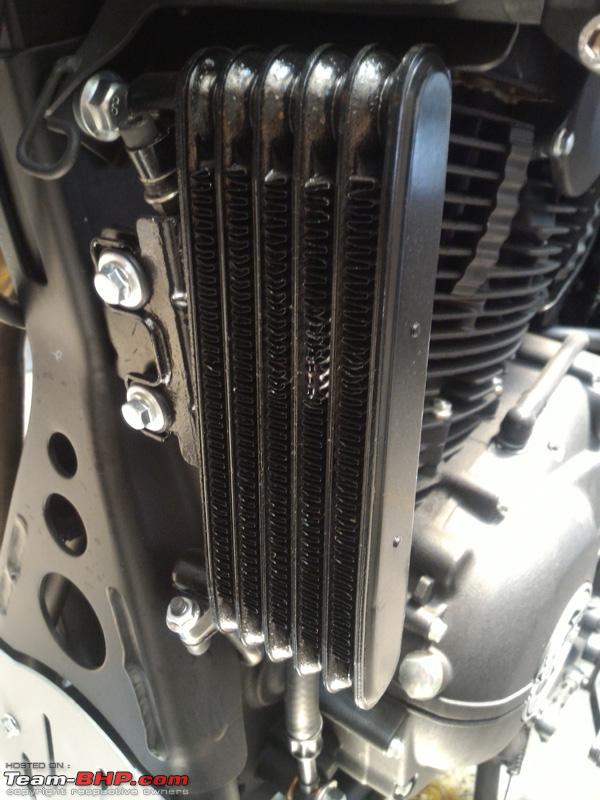

The oil cooler fins were checked. One of two were out of place which were carefully straightened.
